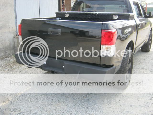

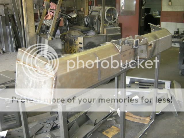

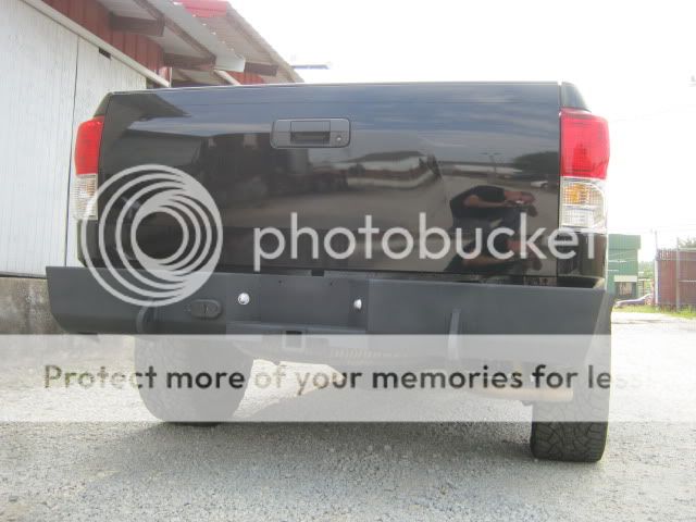

My Tundra was recently used to help design and build a prototype rear bumper for TAG. After almost 2 months of R&D and fabrication, the bumper was completed. I picked up my truck from the shop near Atlanta, GA on August 19th. The receiver hitch was integrated into the bumper. They reproduced the huge brackets, welded them to the bumper, and bolted them to the frame with the original Toyota hardware. This allows my truck to retain the original towing capacity.
Here are the pictures that were sent to me during the build:
My OEM rear bumper was trashed and I had time to let TAG borrow my truck for R&D. I didn't give them a design or ask for any options/additions.

#7 ·
Two months to R&D a bumper? It looks like a fairly simple bumper to build.
#26 · (Edited)
The bumper was probably simple to build. Replicating the factory brackets was difficult and time consuming. Going 2 months without my truck was awful.

#29 ·
The best thing about the bumper, in my opinion, is retaining the factory towing capacity. I also like having the trailer wire connections in the bumper instead of below the towing package where Toyota put them.

#27 · (Edited)
I let TAG use my truck for R&D. The prototype bumper was free. I was never asked to advertise for them. The company's name is nowhere on the bumper or on my truck. I started this thread to show forum members a new option for rear bumpers.

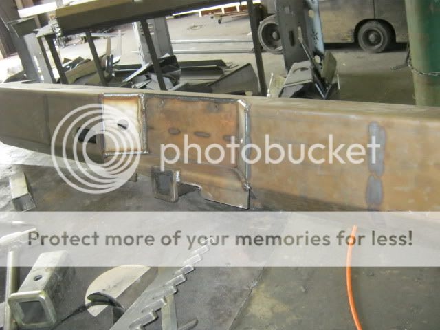

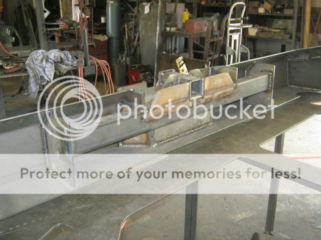

The welds in the first picture don't actually look that great to me. Some of the metal even looks warped. As for the fit and finish I don't care for it either. I mean if it was a 300-400 bumper I'd say ok, but not for the price they are asking. It looks more like something a DIYer built in their garage than a professional company. It actually doesn't look that bad on the truck but seeing the build of it (first picture especially) eh I'm not so impressed.

honestly, the bumper looks too square and plainish, looks like something i would make, then say ehh, it only cost me 130 bucks to make...
if you look at the support plates, you will notice the top plate isn't welded to the supports... if your gonna make a bumper, you might as well do the other 6 inches while your there, with the welder in your hand, and a helmet on...
and the hitch in the rear bumper, unless they have a hellacious mounting surface using the stock hitch mounts, i wouldn't go above 500 lbs tongue and about 4-5k pulling weight MAX...
aside from that, its a nice looking bumper if you want a planish square bumper.

Good input Southern, no harm intended by anyone I'm sure, photo's do show some good weld points on the mounts-looks a little flimsey where they mount to the back of the bumper- otherwise, not bad.

Since a rear bumper is more important to me than a front, I have thought about this a lot.
My points on the OP prototype.
The corners need more work to match the stock. A curved edge and make sure there is a curve on the side pieces to match the quarter panel. A squared off edge makes it look cheap.
Next, the square tubing behind the bumper needs to go full width. You get hit in the corner with that and it will trash your bed.
Lastly, the hitch looks like it would be tough to use. I'd bring it out at least an inch or more. When it is tucked up like that, you are going to find it hard to use.
I would think for a fabricator that using used factory hitches to build from would be a good start. Save a lot of fab work.
#36 · (Edited)
I agree with you. The bumper could definitely be more aesthetically pleasing. The steel is pretty solid so I think the corners will hold up all right. The factory bumper and most of the body on the Tundra is very flimsy. When I backed into a 4x4 wooden post it dented my oem bumper and creased the metal on the rear corner of the bed. I was able to bend it back by hand but of course it never lined up right.
I love the power and comfort of the Tundra but the paint/body seems cheap and weak.
#34 ·
There's more fab work in the mounts than there is in the rest of the bumper. The mounts are impressive. But it would have been easier to just buy a Tundra receiver and build off it.
Reactions: southernsmoke
#35 ·
That is exactly what I thought. They could have used my original Tundra receiver and saved a lot of time. Now I have the huge metal receiver hitch sitting in my garage.
