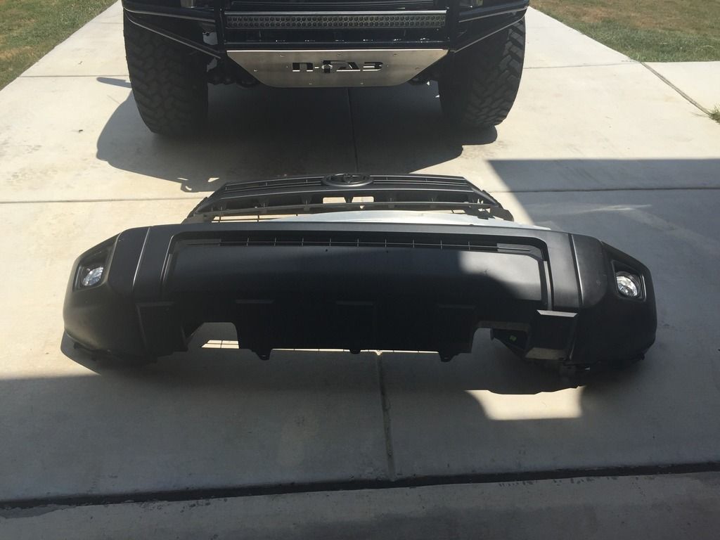

I completed the mod today, thanks for the directions. I ended up putting on 5 3/8th spacers on each of the bumper screws. My only mistake was not keeping a nut in one side while pulling the bumper off. I ended up dropping the bumper off and tearing out a fog light. Dumb mistake, so learn from me on this one! Otherwise, no problems and gave me about a mm of clearance
