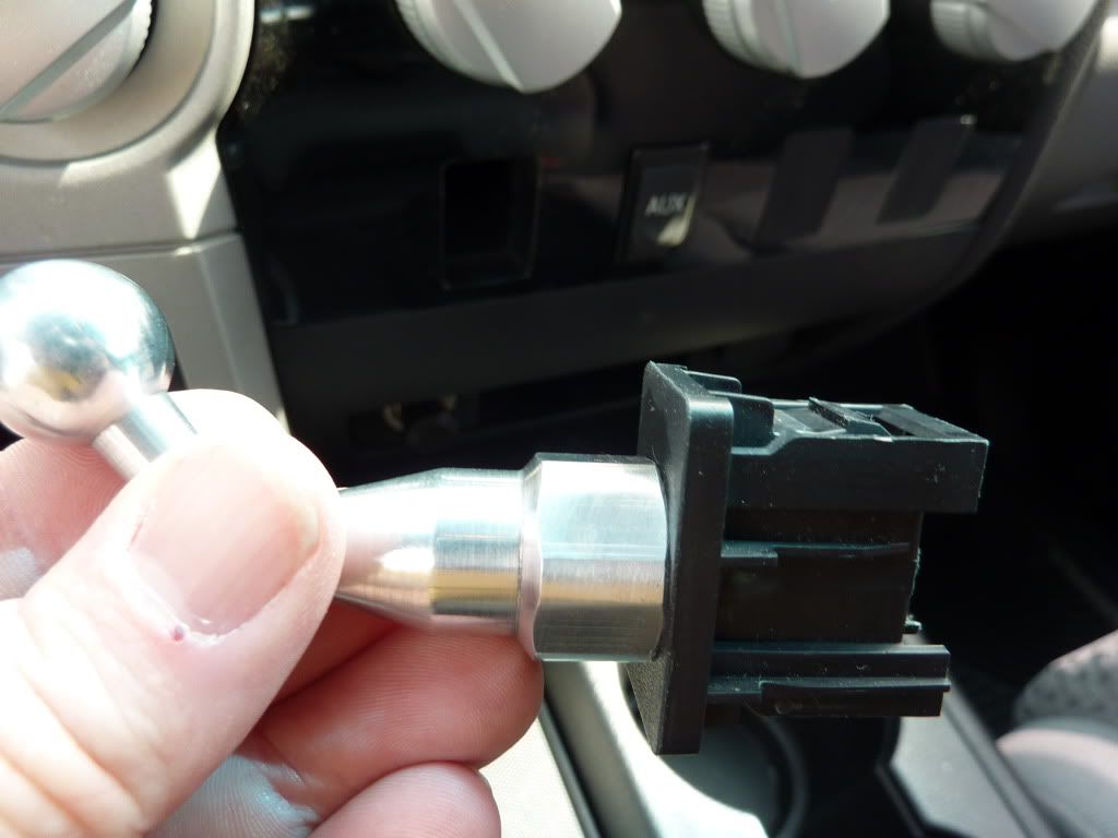

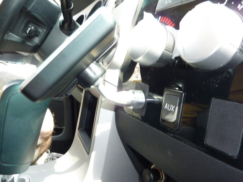

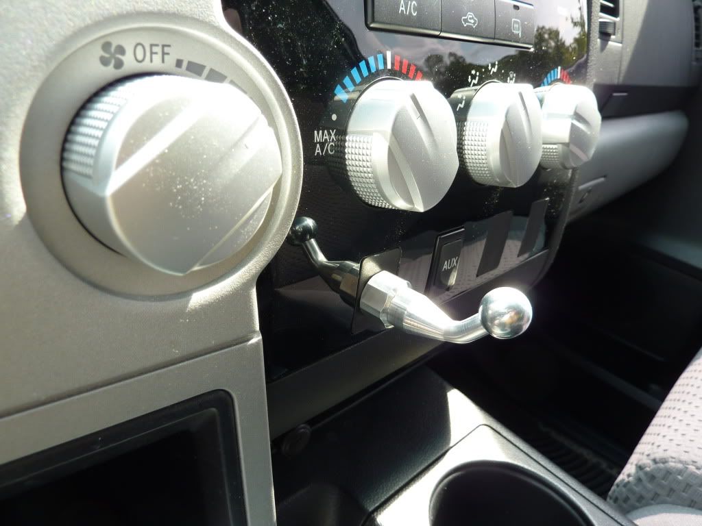

OK...i was looking for a better place to mount my Garmin GPS. I did not want it on my windshield. Besides now a days they can be considered an obstruction and you could be ticketed.
I found this very simple mount on EBay for $18.00. Simply drill a hole and mount it. I didnt think much of it until a couple other fellow Tundra owners saw it and really liked it so I thought I would share it for all to see...

Here is a link to the mount I am talking about...
MOTORCYCLE WINDSHIELD GPS ANGLE MOUNT GARMIN NUVI | eBay
I get great reception on the GPS with the location. The switch blank is easy to pull out. All you have to do is drill a hole center of the switch blank and hone it out in the back just a bit so the screw will fit inside....thats it to the installation.

Where does your GPS cord go when you have it plugged in?? It looks like you have it hard wired, but I'm not sure.
#10 ·
Take a look at the last photo and you can see the power wire running along the shifter and pluged inside my center console. Would like to hard wire it in the future. I have the same mount on my Harley Street Glide so that I can take the GPS along with me.

Got the mount installed, yet I think I might of had to do a little more trimming to get the screw to fit in the back of the switch cover due to the size of the head that was shipped with my mount. The switch cover stays in place, but a gentle tug will pull it out. Still waiting on my 6" usb to mini usb cord to arrive. I will take a picture once I get my usb cable in and can comment on the service provided by the seller. Thanks to gnyhuf for the great find!!
