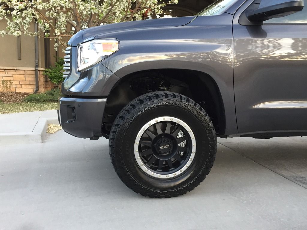

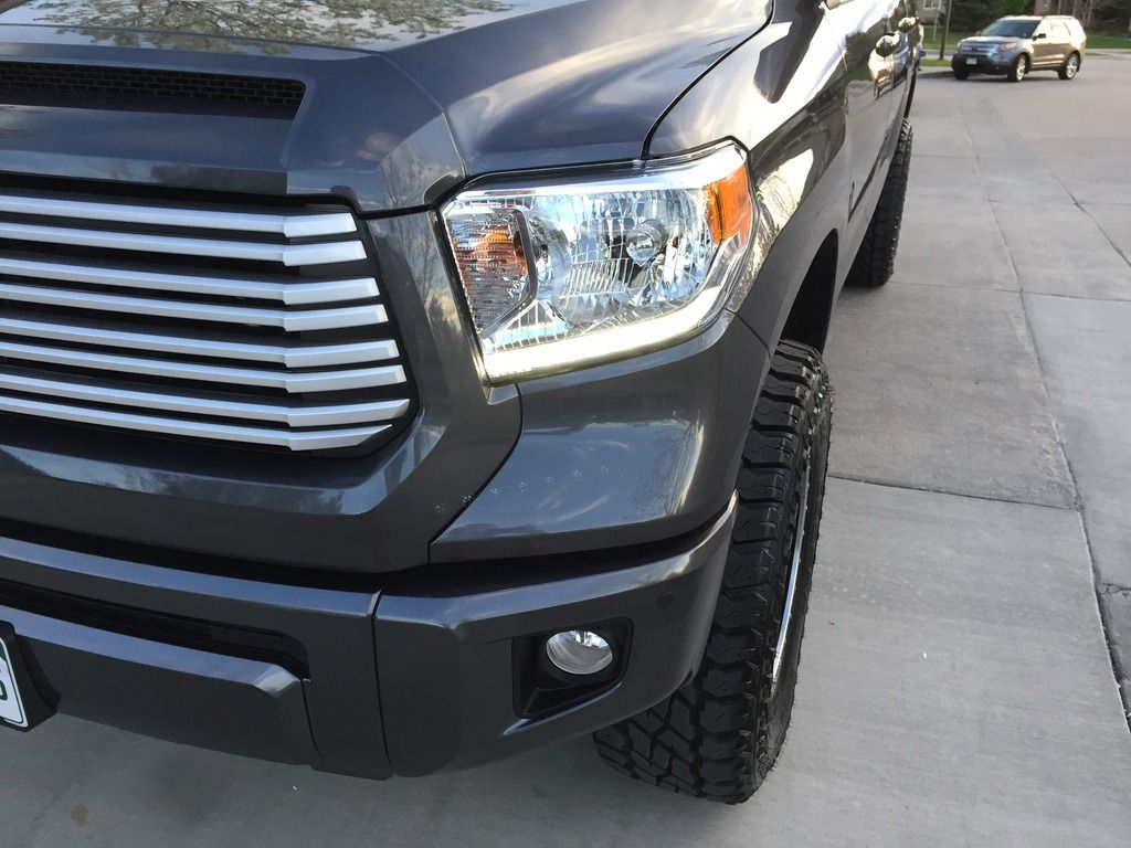

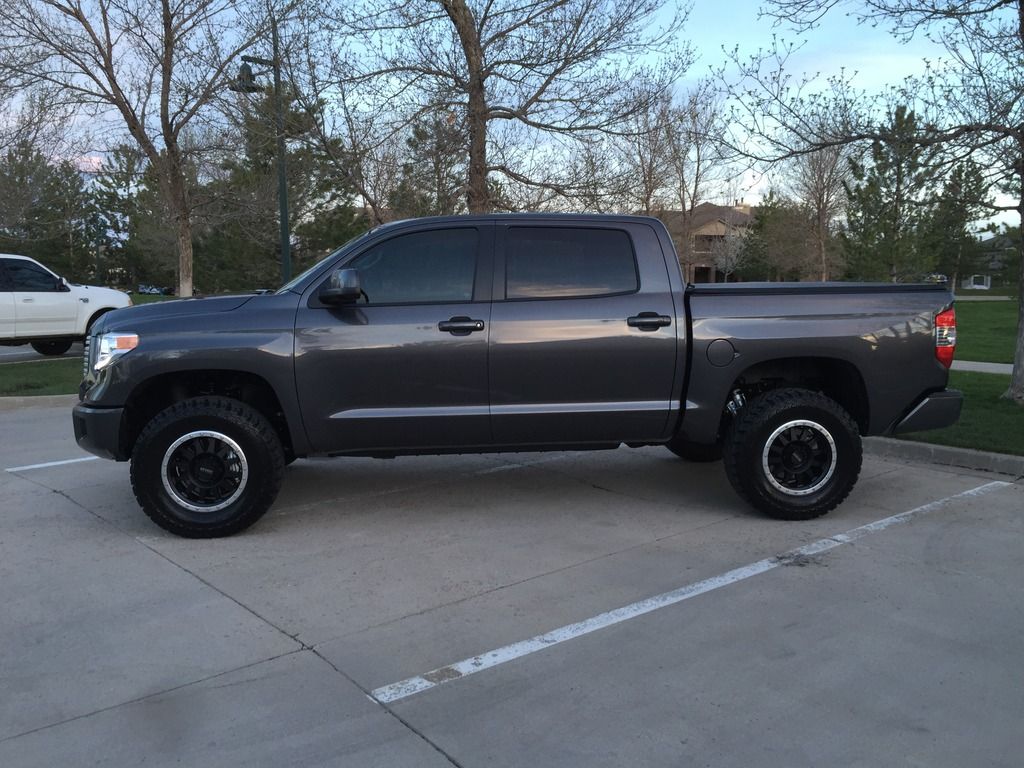

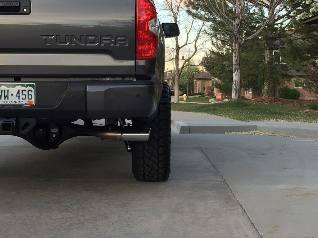

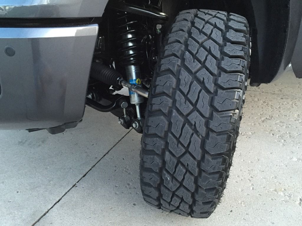

Sold my 12, and picked up a 16.
-18x9 +25 Method Double Standard
-295/70/18 Cooper STMaxx
-6112 front(CB shim on driver side), 5160 rear with 1.5" block
-carrier bearing drop and brake relocation brackets by me
-PTM mirror caps and handles
-badges removed, tint, shorty antenna
-ESP under seat storage
-Tyger tri fold tonneau
-Bedrug
More to come.

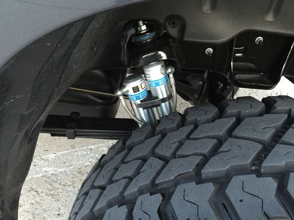

53 Posts
Do the 6112's get about the same lift as the 5100 adjustables? About 2.5 inches? If so, are you having any tire hitting issues at full crank in the front? Diff drop kit? Asking a lot because getting ready to do something similar. Considering 275/70/18 or 205/70/18
8 Posts
holy long bed batman. Every time i see one of these it shows me how short my short bed really is.
Looks great, love the methods.
59 Posts
2.5" lift with top setting and 1 shim on drivers side with 6112's. No diff drop(personal preference), and no rub with no mudflaps, and cutting front bumper liner. 305/65 r18 fit, and looked better IMO, on my last tundra.
