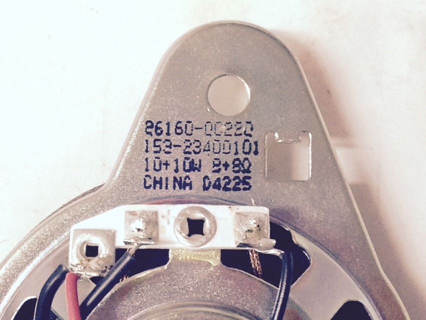

Left is side dash, right is center.
Side..
Center dual coil...
