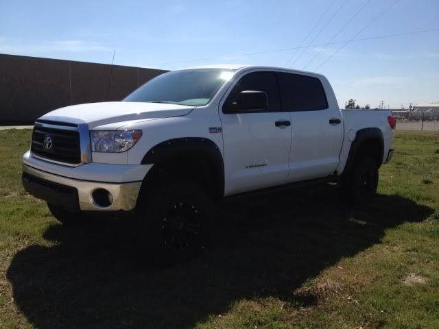

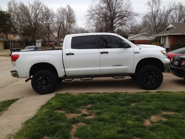

I got a few things done today, so I decided to start a build log.
3-8-13
The day I brought her home.
Today 3-19-13
Picked her up today from having the following done. Rough County 6" lift, windows tinted, and 18x9 XD Monsters with 295-70-18 Nitto Trail Grapplers put on.
More to come REAL soon!!!

sweet truck, looks really good with the lift and the tires. Are you gonna install 4.88's??
Forgive my ignorance, I am new to this. What are 4.88s?
Reactions: dirtydeeds
7,541 Posts
4.88's are the gear ratio of the new ring and pinion that will make your truck feel like a stump puller even with the big tires. It will keep your tranny from hunting for gears and restore fuel economy.
My buddy Julio has a supercharged tundra with 35's. He can burn the tires from a stand still and they stay lit up until he lets off the throttle. It wasn't that way before the new gears with the 35's.
I'm not saying that you should go around roasting the tires:lol5: But that is a side benefit of having the gear ratio correct.
With the bigger tires it's as if you're driving uphill everywhere you go, with 4.88's you're back on level ground. JustDiffs (on this site) sells Nitro gears. I have a set in my 1gen. They are the smoothest set of gears I've ever installed in my Tundra I've blown up the rear end in that truck 8 times from driving it like this:

177 Posts
Looking awesome man. I have been wondering what that size tire looked like on a 6inch cause I have them and probably not to long going to switch to a 6 inch. Doesn't look to bad at all. Looking good man.
