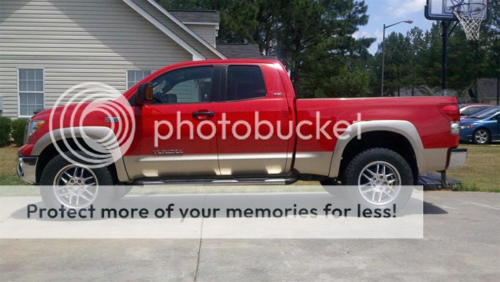

Wow, that's close. They do look good.
I guess you'd have a little more space on a LTD 20X8 as opposed to your 20X9 offset being same.
Edit:maybe not...I think stock LTD's are +60 offset.

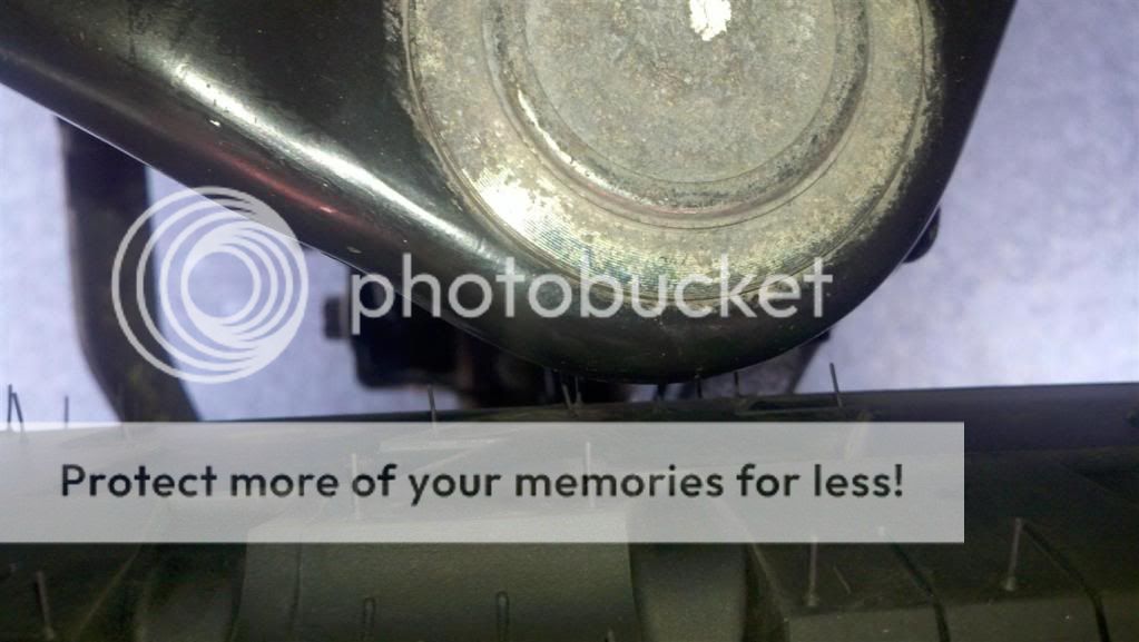

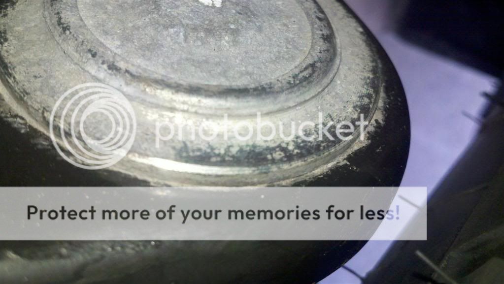

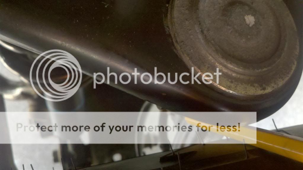

Truck look perfect!!!!! Congrats!!!! BTW my 305/50r20 are that close to the ucas.
Really? With my 305/50/20's I could easily fit the tips of my fingers between the control arm and tire. I would have never even attempted 295/60/20's if I was as close as you are. I can't even fit my pinky down there now. I bet if I wrapped a piece of tape around that pencil it would rub. If my alignment slips I'm screwed. :eek:

Hopefully someone can chime in and help me. The picture with the Tire and the UCA is it that close because of the height of the tire or the width? I'm assuming height but I honestly don't know.
If Height is the problem would more LIFT fix this issue?
