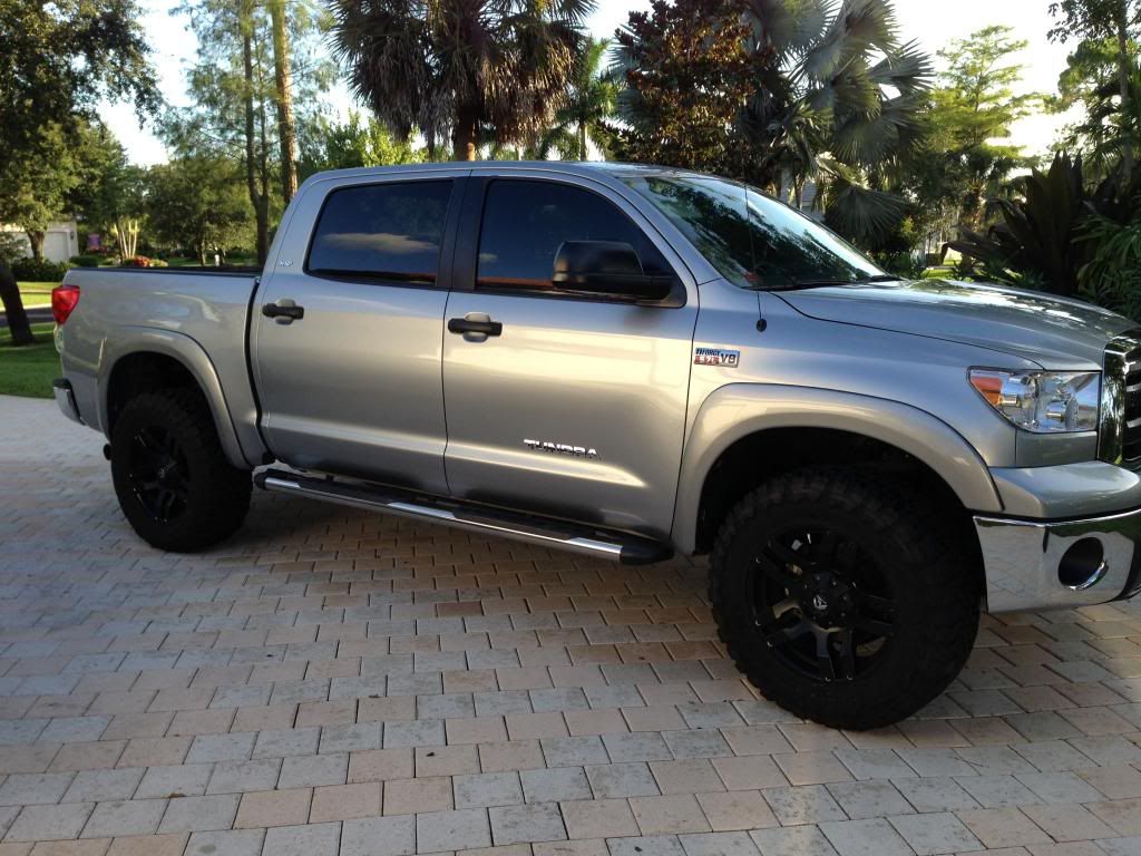

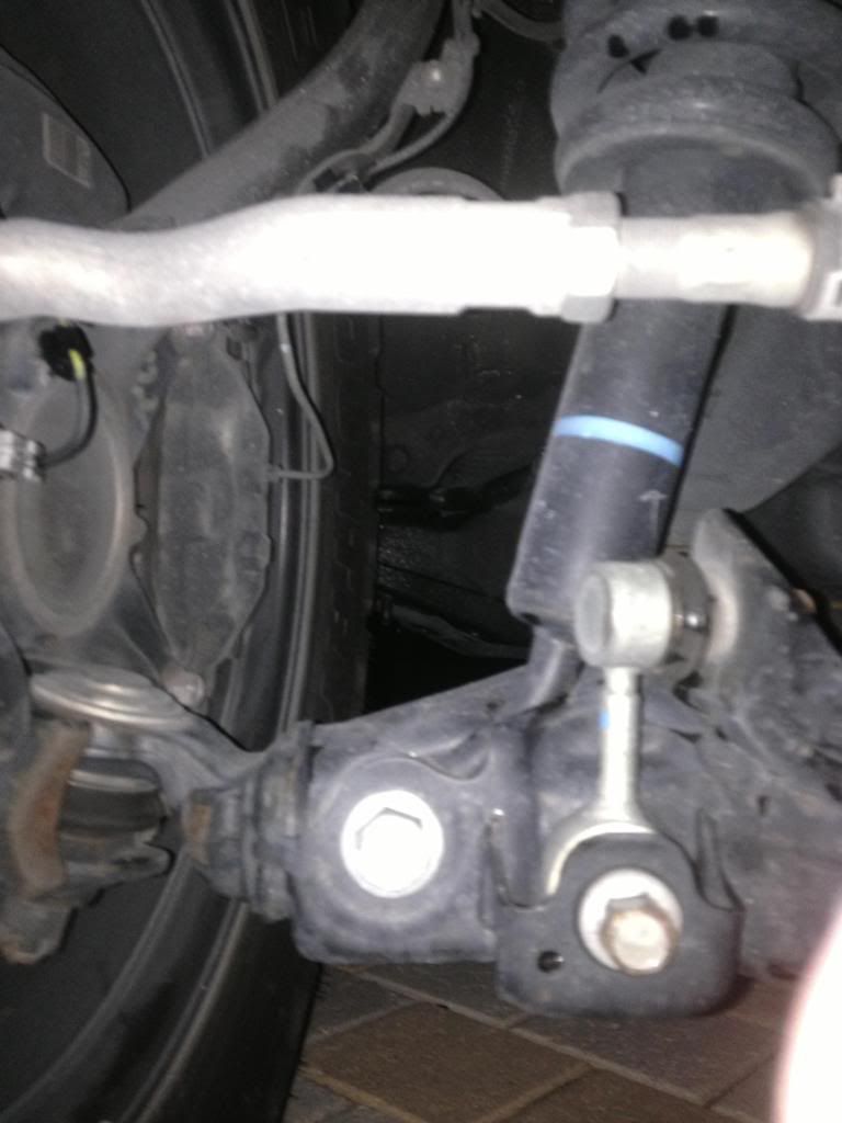

Recently hit a hole on the side of the road, and pretty severely bent up my stock strut, my truck is lifted with a ReadyLift 3-2 spacer and block kit with 35x12.50 Toyo M/Ts on Fuel Pump 20x9 +18s. We are now looking at our options of upgraded shocks and/or coilovers, we may also consider getting rid of the 3" spacer in the front so that we can have a more offroad capable vehicle. What would y'all recommend for us to do other than stock to make the vehicle more capable of offroading to avoid this issue as we have realized that throwing more stock shocks on while facilitate an opportunity for this to happen again! Please help us and thank you for your time :D It is 2WD also.
