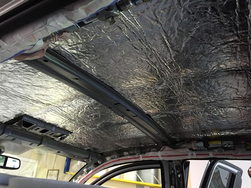

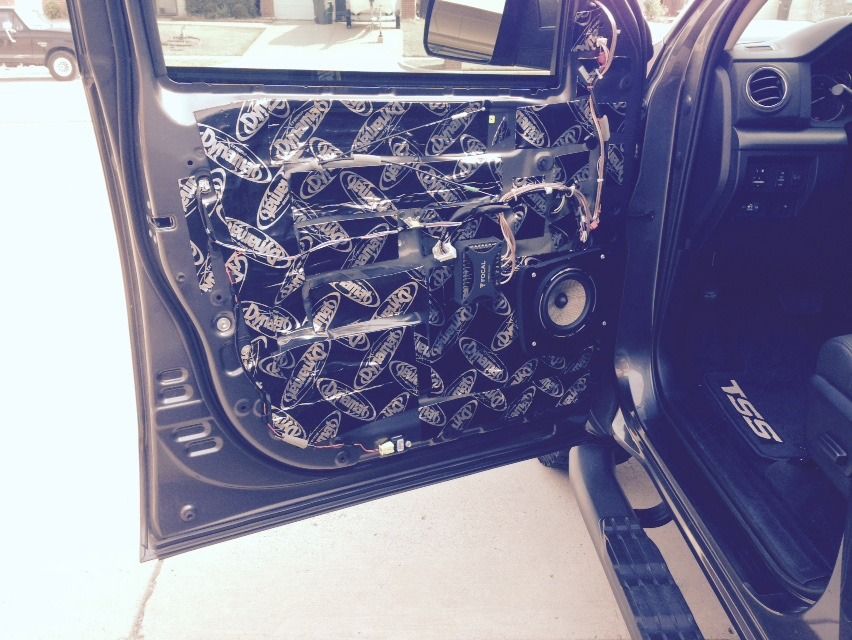

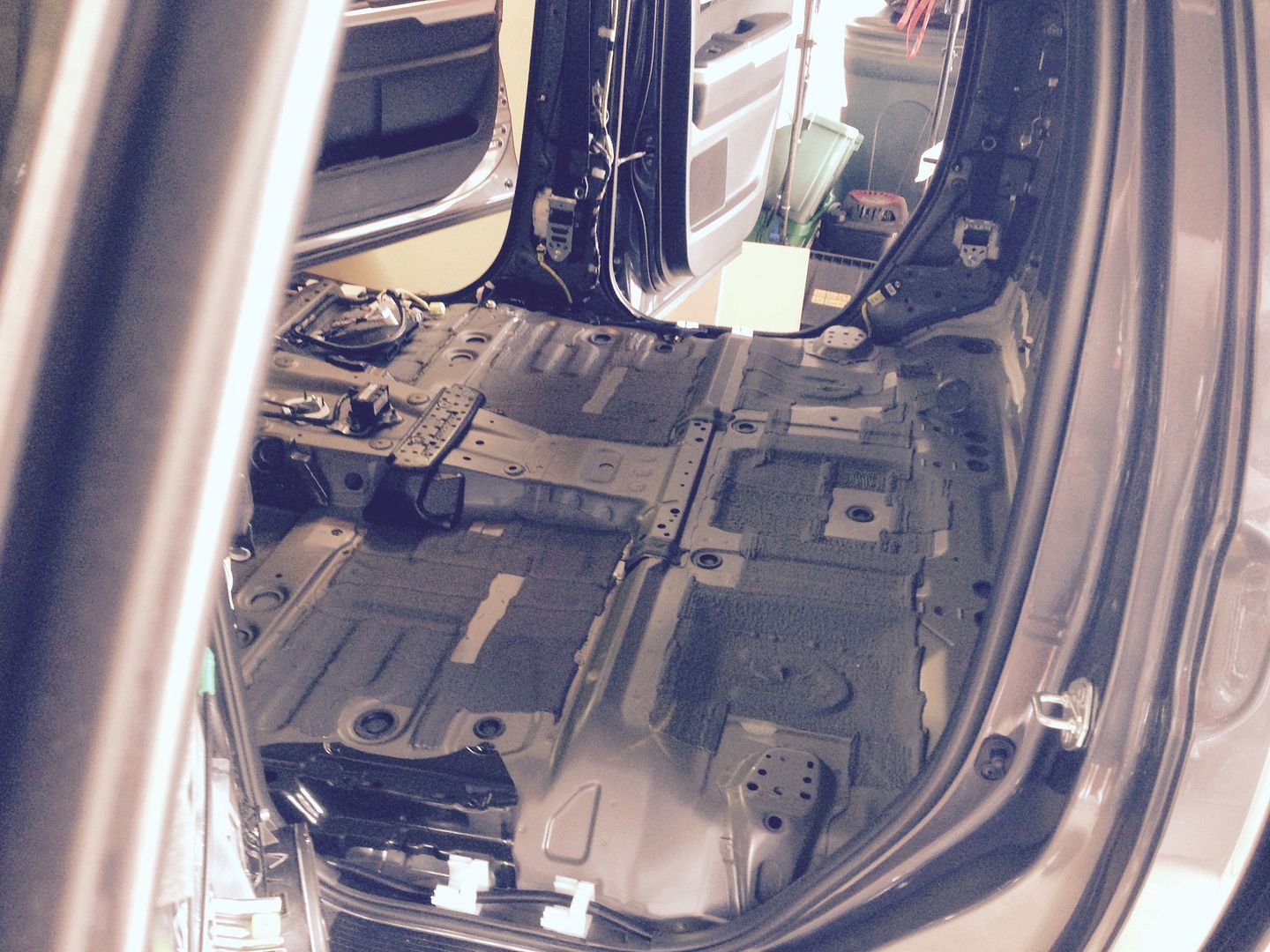

I did all my doors (inside and out), back wall, and entire floor area in my 2014 DC.
Didn't do the roof.
Did Dynamat all over and Dynaliner on rear wall and under the back seat.

Took me a weekend.
Wife immediately noticed the difference in the noise reduction with my BA muffler and road noise.
She thought I was nuts when I pulled out the entire interior of a new (at the time) truck..
I think I over did the doors because they are heavy and slam with the slightest closure.
I put in on the exterior door skin where ever I could reach it.
I'd put less on the inside of the door (on the plastic under the door panel as pictured) if I did it again..

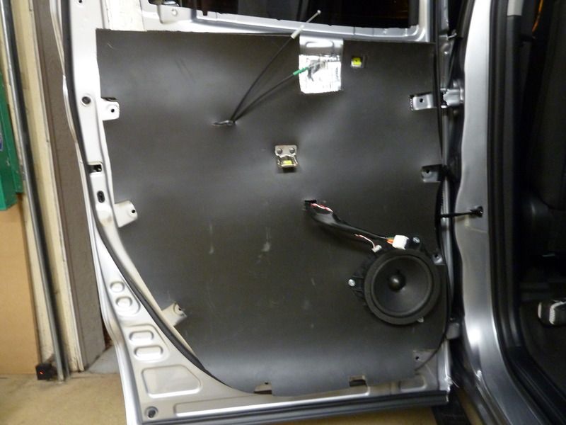

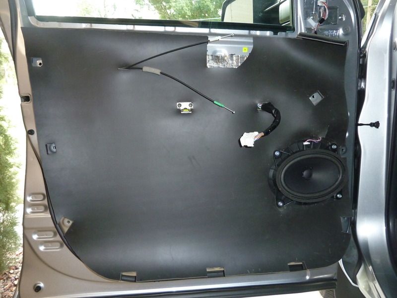

I here ya, but these guys are right, pretty easy to take these trucks apart. I was hesitant, but gave it a go. Did my doors, used Noico.
Noico 80 mil 36 sqft car Sound deadening mat, Butyl Automotive Sound Deadener, Audio Noise Insulation and dampening https://www.amazon.com/dp/B00URUIKAK/ref=cm_sw_r_cp_apa_TDH4BbRFK950K
First time, so I can't compare it to others.
Still waiting to hear back from sound deadener showdown, think I'm going to do the MLV as well. Vehicle door Vehicle Car Automotive exterior Auto part

BTW, in your pics, is that our trucks normal stock speaker in the front?
I hear ya with the clips, lol. Yes, that's the speaker that came with my truck. Not sure if all the trim levels are the same. Good luck.
