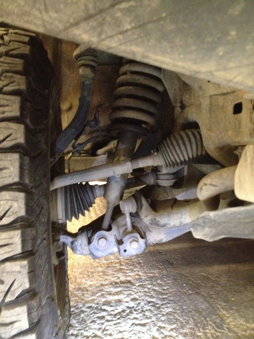

Probably about a week after I bought the truck I went to Allenspark CO to visit a friend and explore. I decided to blast up a pretty smooth trail and let off the gas right at the crest which resulted in the front end slamming down and my drivers side shock blowing.
That resulted in me buying an OME kit from @dirtydeeds and shackles from @Coachbuilder1 as well as SPC/Light racing UCAs from Wheelers Off Road
Once I got the suspension all straightened out I got rock sliders and 3/16" skids for my truck from Budbuilt. I got an alignment and headed out to Nevada/ NorCal to do some off-roading with my cousin.
