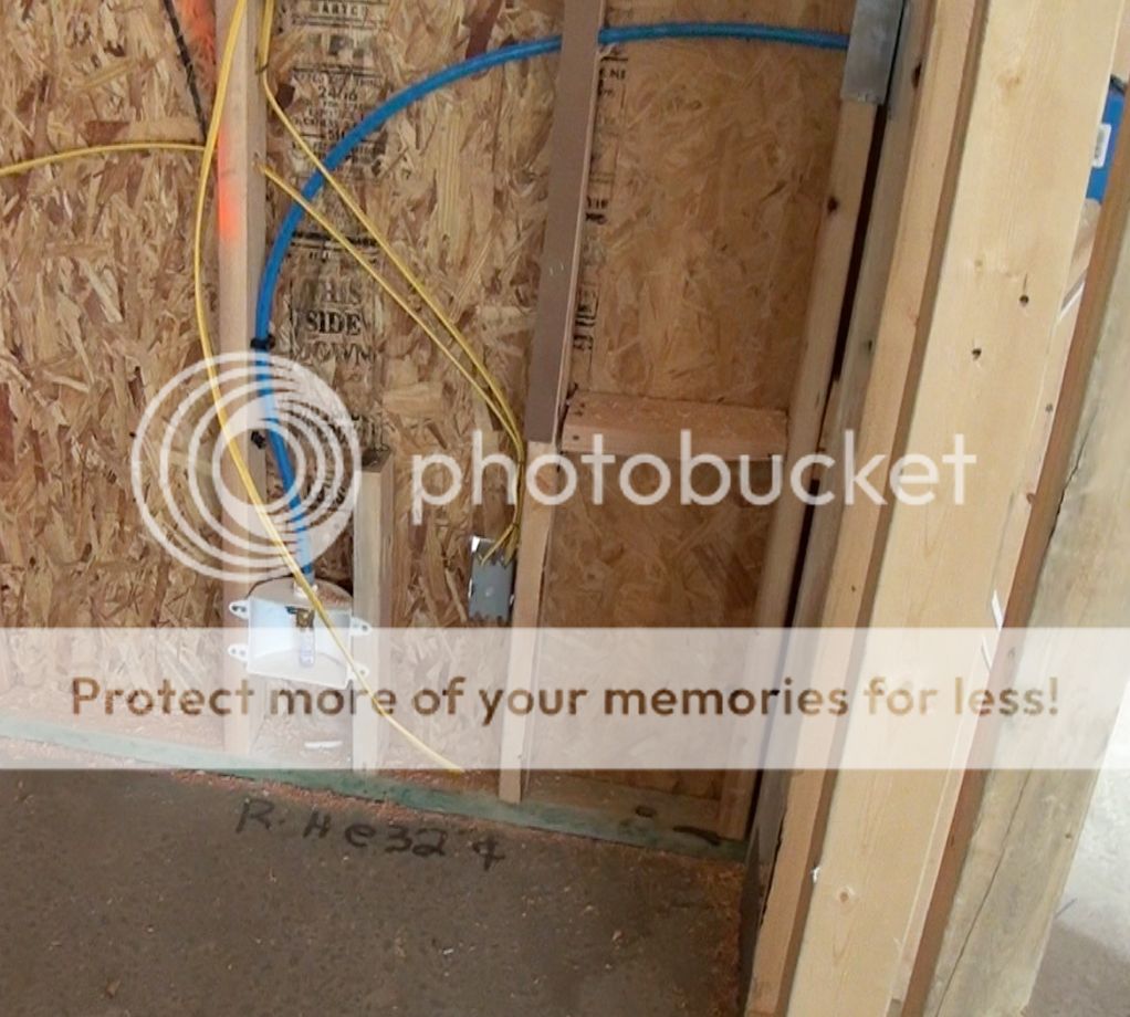

There photos were taken during construction
Kitchen island sink has 2 cold water and one hot water line. Currently, both cold water lines and hot water line are tied to kitchen faucet.
This is my current water line to fridge. I believe it comes from one of the two cold water lines mentioned above.
In this photo, you can see a cold water line coming up from under the slab (from kitchen island sink):
How do I get my RO line over to the fridge? Does it go through one of the two sink lines over to the fridge? Then do I just use one of the two cold water lines for the faucet now?

Am I correct in assuming that I snake the 3/8" RO line to the fridge through the existing 1/2" water line? I'm assuming that's why there are 2 cold water lines under the sink.
10,981 Posts
I'd use the one as the feed for the RO and then use a quick connect fitting to connect the the storage tank to the line going to the fridge. No need to run another line if they already did it for you.

Yep. This thread long before I joined TT, but I learned from experience that if the builder runs a stupid 1/4" (3/8" not much better) line through the walls, you'll have a big pressure drop from RO unit to fridge if the fridge is on the other side of the kitchen. Fridge dispenser trickled until I fished another bigger line through the walls. :banghead:
