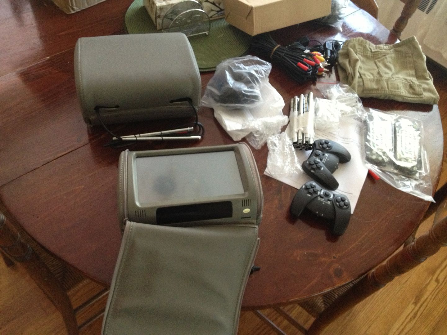

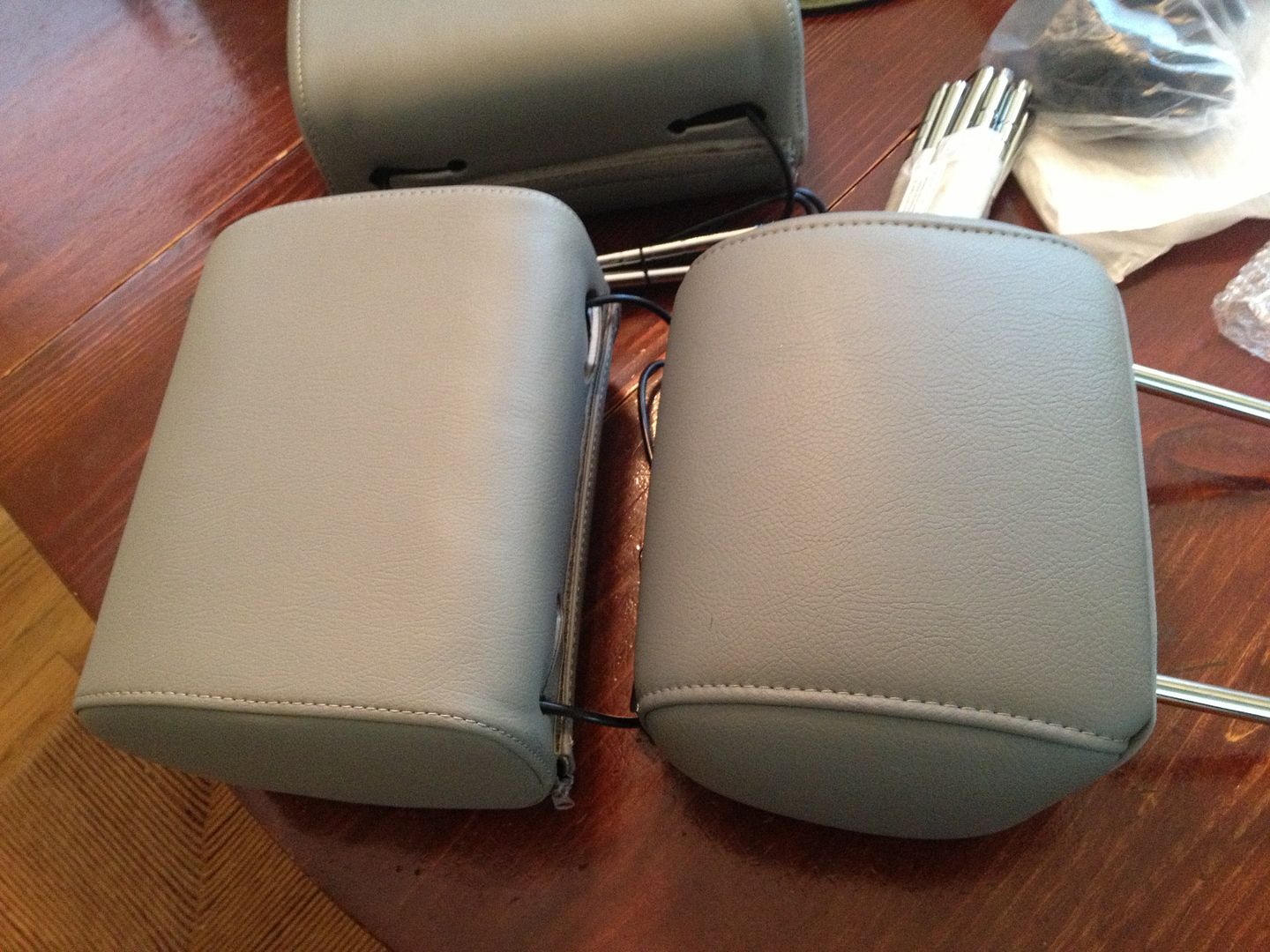

They came very well packed, 2 headrests, 3 different sets of posts (metal), plastic sleeves which I did not use, 2 wireless headphones, 2 remote controls, 2 gaming remotes and 2 DVD's full of video games.

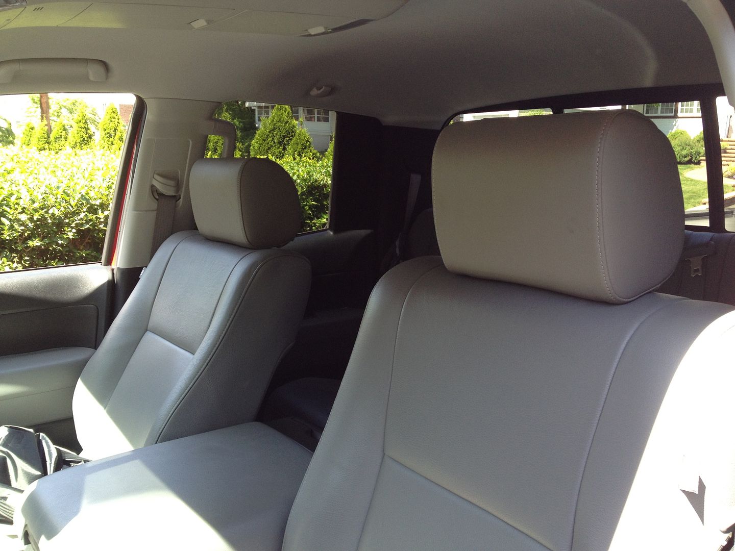

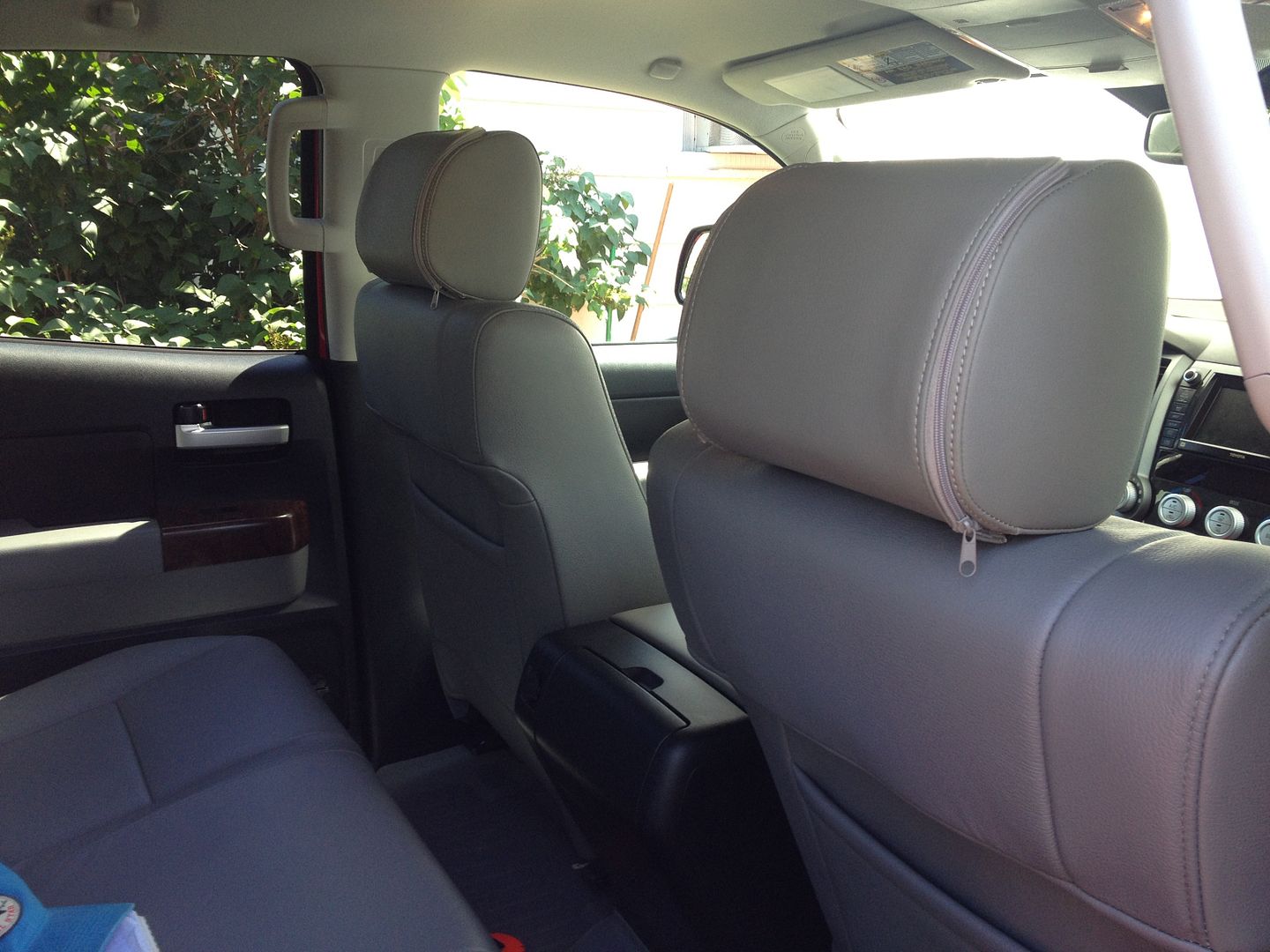

The headrests are a bit larger in size and not a round as the original ones, they resemble the rear ones in my opionion so the shape seems to fit the truck.
Material color is not that close a match but hey, close enough for an aftermarket part.
Once you figure out the correct post size, you slide both wires thru the posts and adjust the post spacing (between posts) simply by pushing/sliding both posts towards the center.
Stick the wire connectors thru the holes on the top of the seat (they pretty much fall down the seat back far enough to grab them from underneath) and then slide the new headrests in place. Piece of cake
Onefeature I find to be great is that the headrests tilt back or front so you can adjust them to a comfortable position.

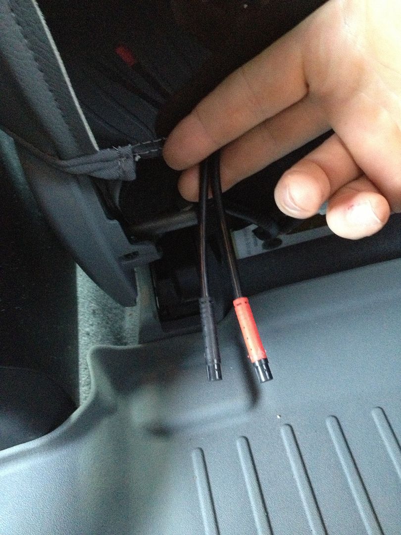

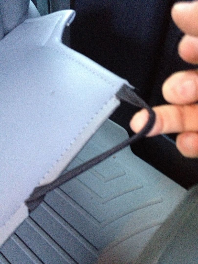

Next I unhooked the 2 elastic loops from the bottom part of the seat back to release the flap to acces the wires. I stuck my hand about 8" up the back and found the wires in a second.

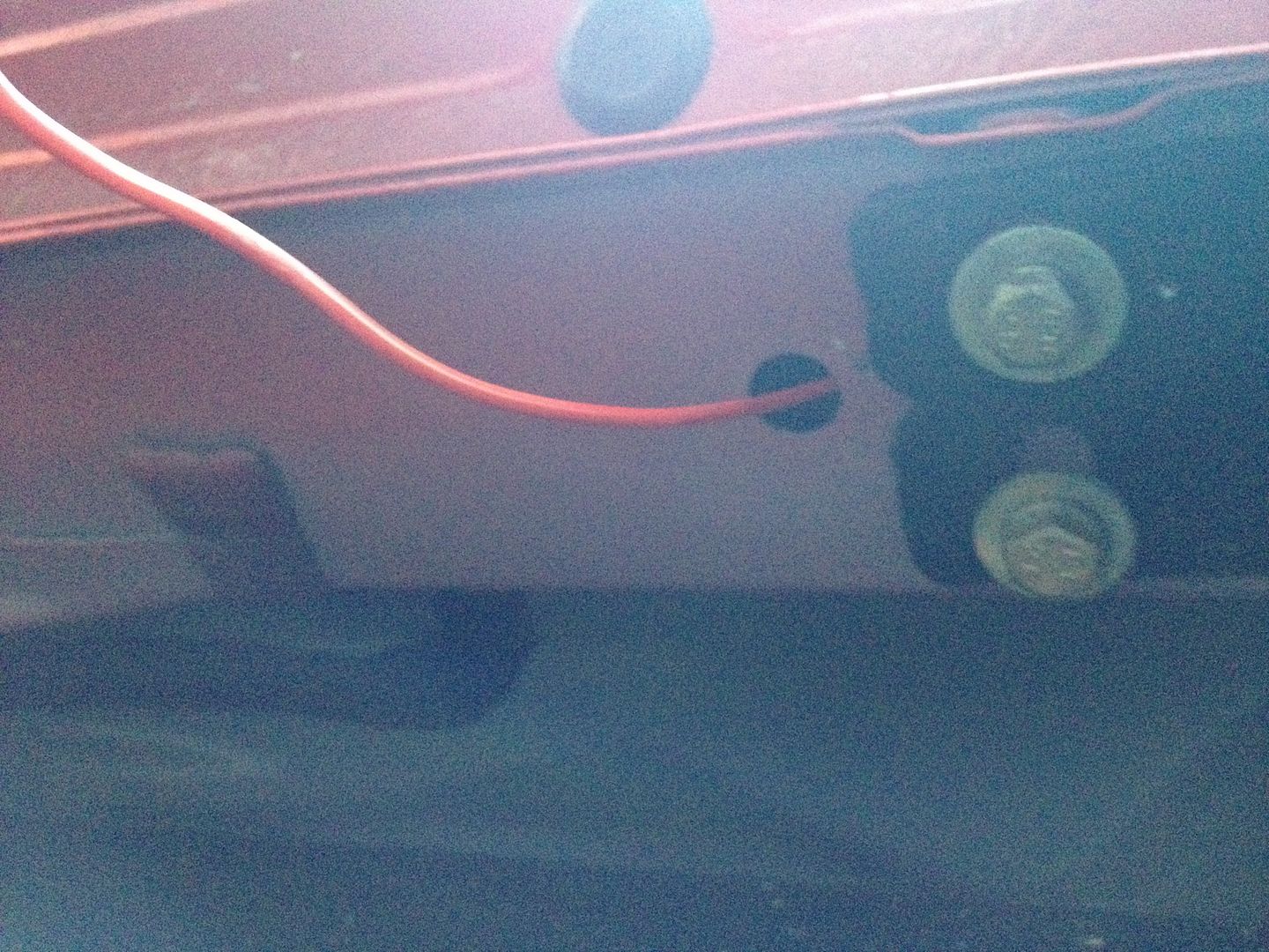

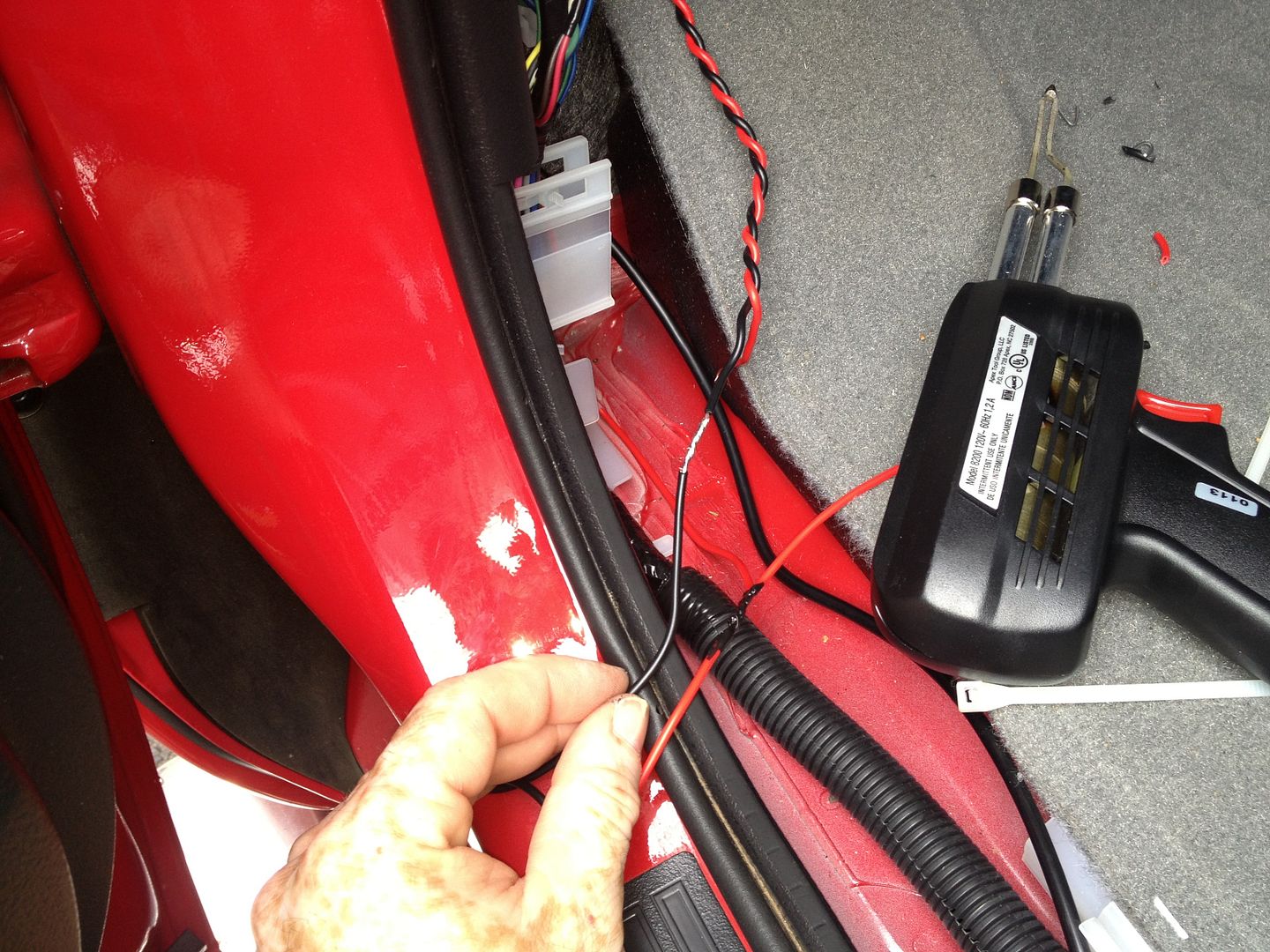

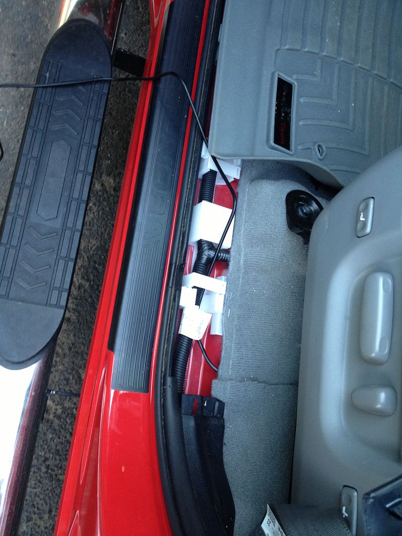

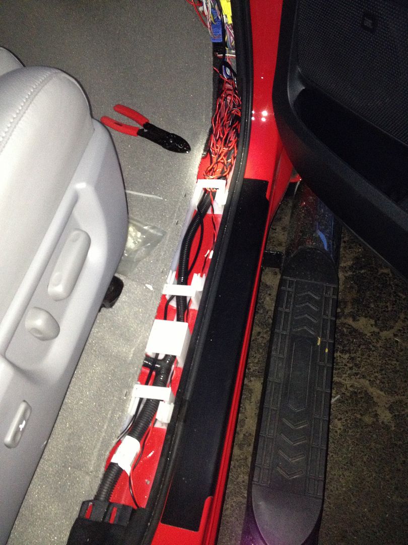

Next, remove the door sill panels and the kick panels to run your wires.
In reality you can run the wires thru the drivers side only, however, I chose to take advantage of the "mess" and install my L.E.D. strip courtesy lights :cool:
Fishing the wires for the L.E.D.'s
Day 2: fabricating my "y" connectors to hook up to the fuse box via ADD A CIRCUIT
Not very impressed with the liquid tape, I thought it'd dry faster and harder, just an FYI

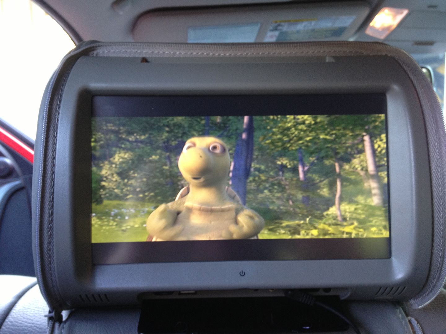

And at the bottom, videos of the end result. So far I am very pleased with the autotain DVD headrests. The image quality is surprisingly good. The speakers blow in the worst way, but you can connect them wirelessly to the head unit via the built in fm modulator or use the headphones which ultimately make the most sense:lol5:

Also, the video seems pixelated but that's because of the download quality (photobucket) the actual video is crisp and detailed.

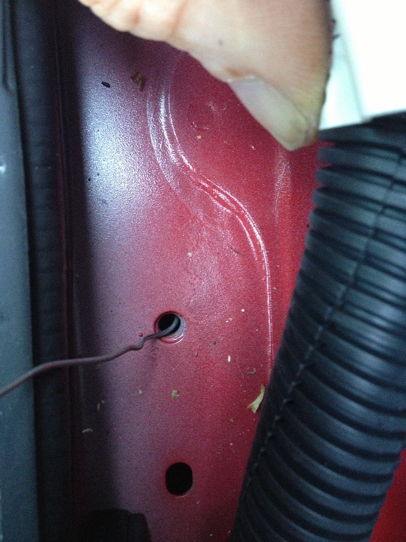

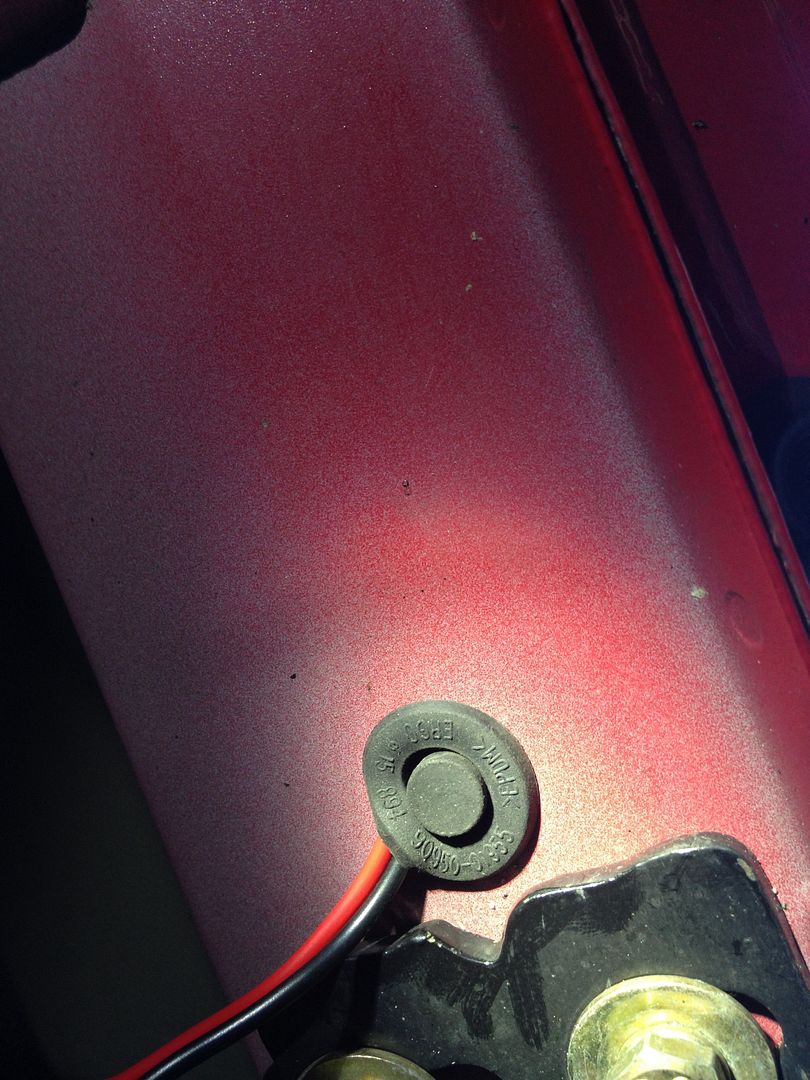

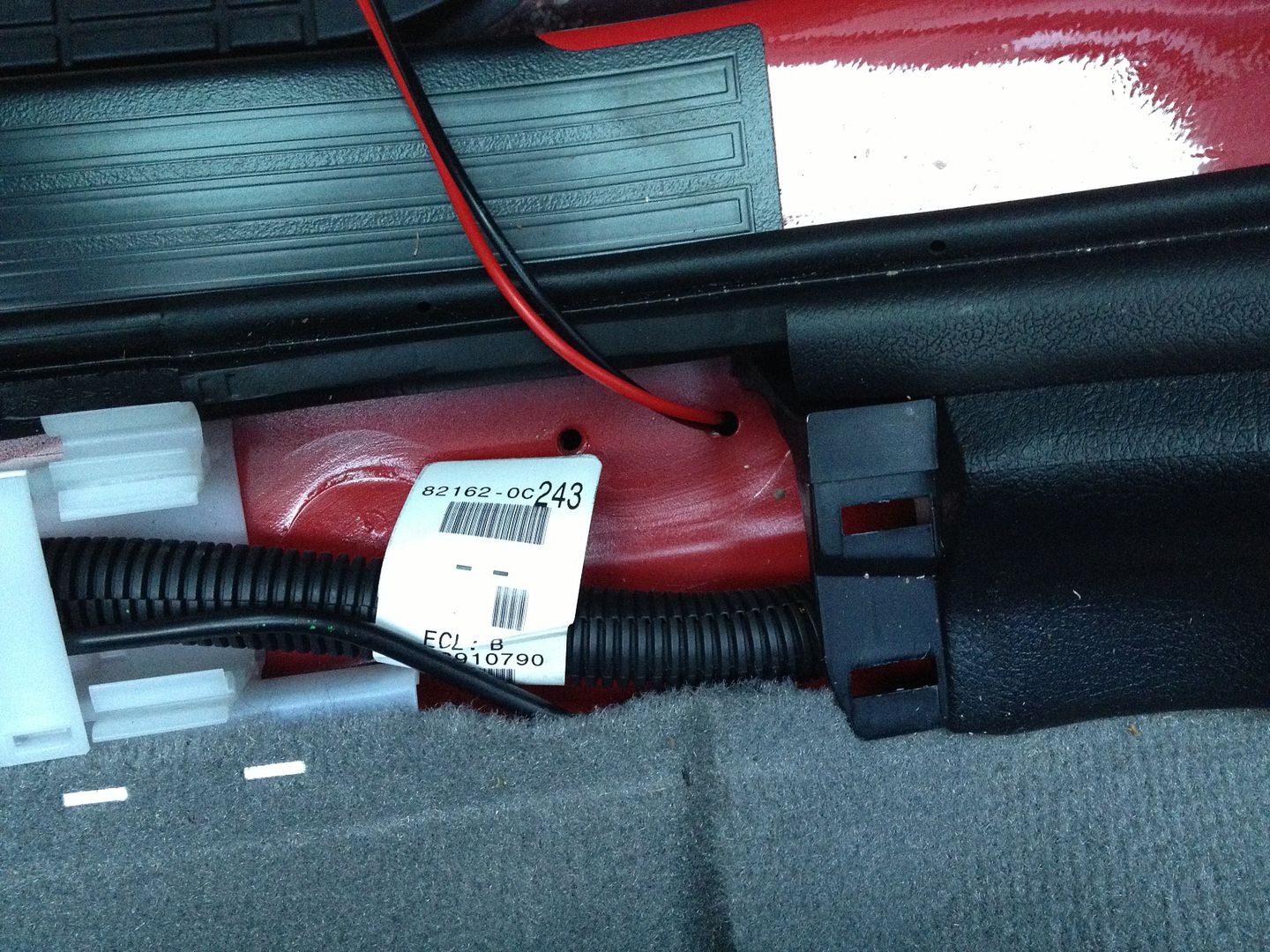

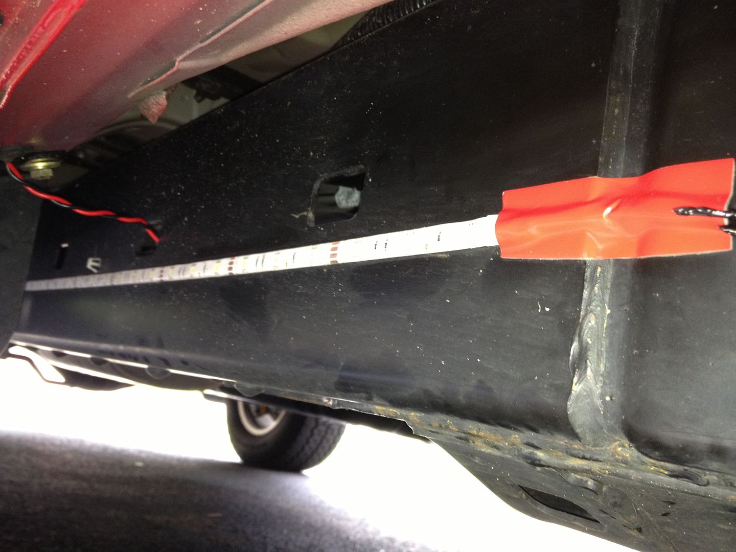

That looks good, where you ran that wire in from underneath the car I would recommend running it through the grommet instead of pinched between it and the metal it will eventually run through the insulation on the wire, if you want it to have a good seal poke a small hole with a tiny screw driver it will be hard to force the wire through but the grommet will seal tight against it. Hose headrests match really well with your truck. I need to put some in mine my kids hate riding with me.

The one thing I would complain about is the headrest position. I don't like that you can only either watch a movie or ride comfortable. IMO the screen is the one that should be adjustable so both the driver and the passenger can have what they want. Maybe I am just too picky :dunno:
The photo of the wires pinched by the grommet is from when I started the install and left it half way. I did route the wires thru the grommet like you said. What I didn't do was buy the corrugated plastic hose thing for the exposed portion of the wires that run from the grommet to the strip (around the frame)
