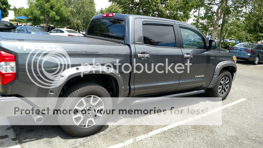

I installed the smooth Lund fender flares with rivets. Black and MGM doesn't really match together. I plasti dipped mine in anthracite grey, which is the closest color match for MGM, but it is a bit lighter. I used about 1 can for each flare and that is about 6 coats. Then I added 3 coats of glossifier for UV protection. I recently washed my truck using a pressure washer and no damage to the plasti dip.

Thanks. At first I didn't like it but it grew on me. I also added 1.5" spacers from wheel adapter.com to be flushed with the fenders. Luckily they are local to me and they installed for me on the spot. Great mom and pops company to work with.
