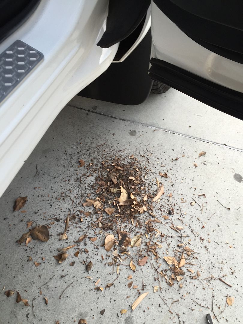

I decided to give my engine compartment a detail today and noticed a bunch of leaves and debris under the cowl vent. Apparently, the PO parked under a eucalyptus tree and half of its leaves ended up under the cowl. Well, the area under the cowl vent is designed to direct water behind the front wheel in the quarter panel. It works for water, but not debris. Here's a picture of the area after I cleaned it. I didn't take a before pic, but it was gross.
I knew there had to be a ton of debris down in the quarter panel, but I didn't know how to get to it. I first tried taking off the mud flap, but that was a dead end. Then I opened the door and looked behind this little rubber flap.
Bingo, there it was! I couldn't believe how much stuff was in there. I can't imagine this is a good thing to have hiding in your quarter panel. Looks like a recipe for rust and corrosion. The rubber cover just peels back and pops back into position when your'e done. I figure this is what it was designed for.
And here's everything removed. I'm going to check this area from time to time and blow it out with compressed air.
I posted this so that maybe others can look to see if they have a tree's worth of leaves living in their quarter panels. Hope it helps.

thanks, was it hard to pull off the cowl?
Funny thing that leaves & debris in the cowl really bother me on our cars and trucks in the family. When the my 20 something boys come home for a visit, I end up cleaning all this crap out... it's just can't be a good thing to clog up the venting.
one of my pet peeves...

The cowl comes off easily. There is a button screw on either end and several tabs along the bottom. Remove the wipers with an 8mm? wrench and it pops right off.
I'm pretty anal about that stuff too.

Yep...all that debris holds moisture against the metal...perfect scenario for rust...

I had the same issue years ago when I bought my old Taco. I had an ant problem... Ants everywhere and couldn't figure out where they were coming from. I searched the truck top to bottom and cleaned it out thinking there was some old food somewhere. Turns out the ants had built a home in all the debris behind the fender. Flushed out all the debris with the hose and the problem was solved. The previous owner must have parked under a tree or something.

Make sure you get it back on good or pad the touch points. The windshield cowl is one of the worst noise makers on the Tundra.

yeah I found this on my 08 tundra too. Just pull the little flap once a year and rinse with a garden hose
