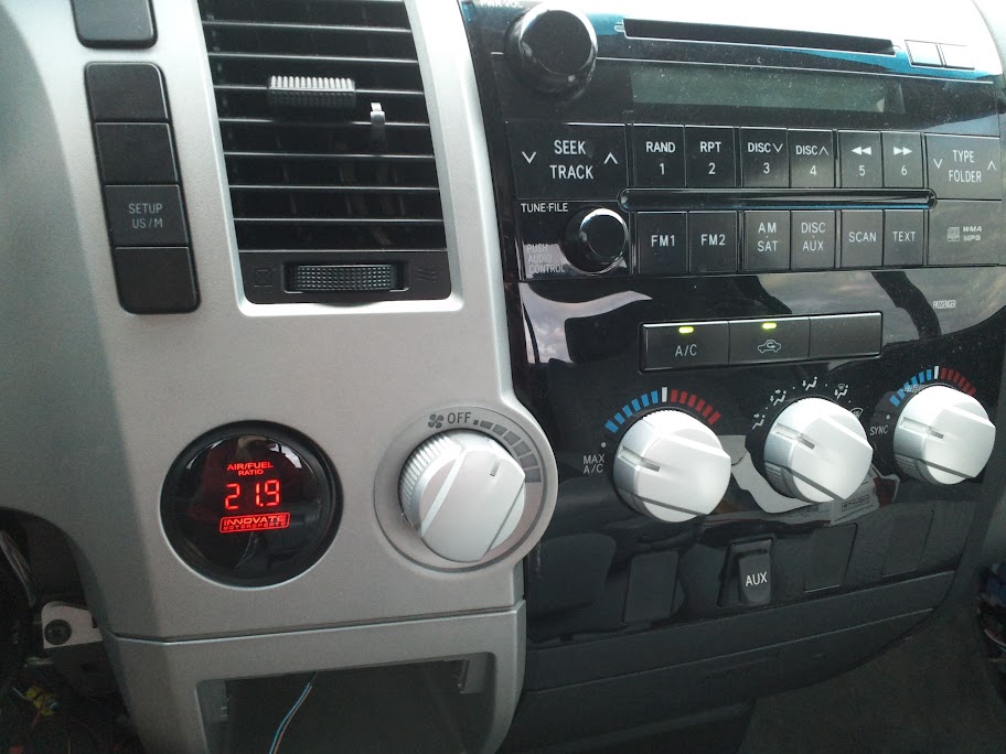

I still have to button it all back up, but it works and looks pretty good. The truck runs 12.3-12.7 AFR at WOT. I am about to order a Rijon gauge plate to replace the ashtray. That is where my boost gauge will go.

Looks good. Nice fit.

Where did you insert the bung? When i first installed mine it didn't read anything because it was too far out. I had to cut the bung in half to make the sensor go all the way in and read properly.
See pic. Its the one on the right. Its located at the end of the headers on the driver's side.

I noticed the 02 bung did seem about twice as long compared to the one that came with my old PLX wideband.
I could maybe try and take a cutting wheel to it, but I'm afraid I may mess up the threads.
