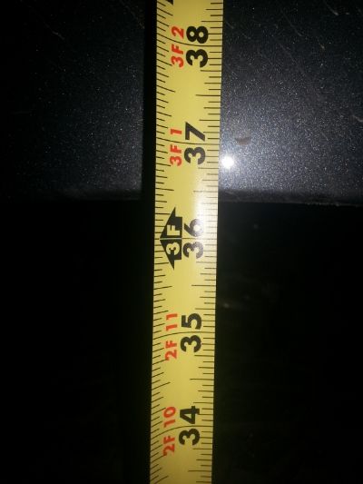

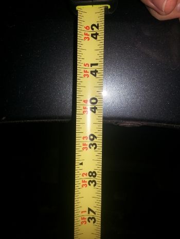

Hey all.... I thought I would post this information for anyone thinking of buying this kit. I had the front installed this morning at a local offroad shop and planned to install the rear myself at a later date. As of right now I dont think I am going to even install the rears.... the truck is almost perfectly level using just the front 3 inch lift.
Driver Front Before - 36.5"
Driver Front After - 39.5"
Passenger Front Before - 36 5/8"
Passenger Front After - 39.5"
Driver Rear - 39.5"
Passenger Rear - 39 5/8"
Before
After
As of right now I am going to keep just the front on and leave the front off. The truck is almost perfectly level and I am expecting a bit of settling over the next few weeks. I will report back later with information on how much it settles. I am running a set of 18x9 +13 Dick Cepek DC-1's with 285-65-18 Nitto Terra Grapplers. As of right now when I turn in reverse either way the tires rub on the mud flaps on the front bumper.
What do you guys think?
