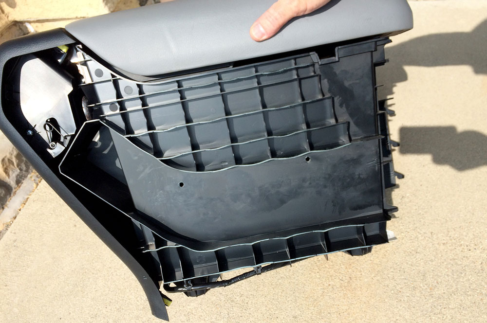

Anyway, I removed the console, first the forward cup holder part (just pry it up, it’s held in by numerous clips), then the actual console/armrest part. You do not have to remove either seat to perform this installation. This is what it will look like with the console removed.

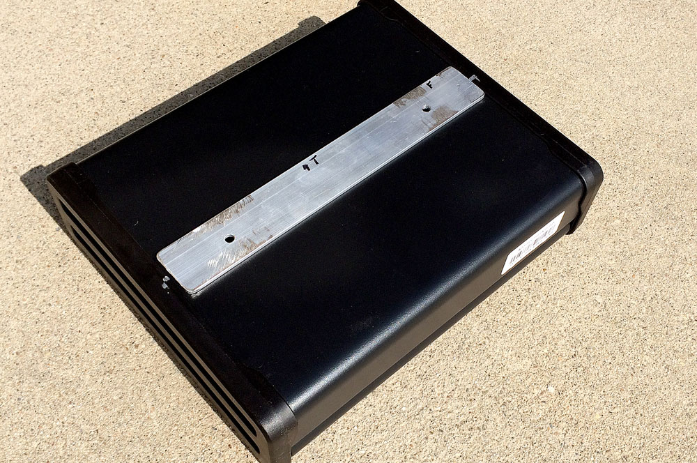

Next I made a backing plate from a piece of 1-1/2 in X 1/8-in flat aluminum bar stock. I just used the safe as a gauge to cut it to the proper length, then I taped it to the outside of the safe, opened the door, and marked the spot to drill the two mounting holes from the inside. Here’s a shot of the finished backing plate sitting on the safe. It doesn’t have to be pretty. It will be hidden once the installation is complete.

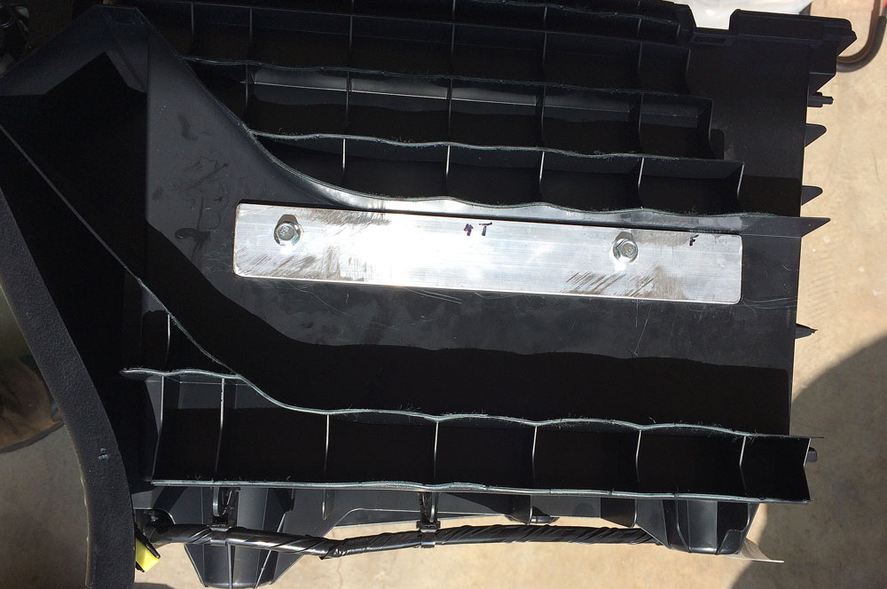

Next was drilling the mounting holes in the console, then attaching the backing plate and bolts between the inner and outer walls of the console on the right side.

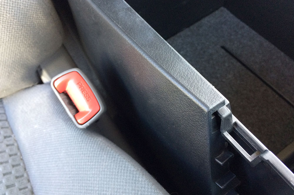

Next I pried the right (passenger side) outer wall of the console away from the console box. There is a false duct there and this piece is held on with a combination of glue, clips, notches and tabs. The glue is only on the thin structural ribs so it’s easy to pry it away and break the adhesive. Here’s a bit of a blurry shot that I took while actually prying the right side off the console.

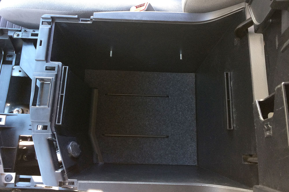

With the right (passenger) side exterior wall removed from the console I drilled the mounting holes from the inside where I marked earlier using the safe. This is what it looks like once the holes are drilled.
Once the two holes were drilled I affixed the backing plate and bolts. I used M10 x 20mm x 1.0 bolts. Because I needed the backing plate and bolts to stay in place long enough to get the nuts tightened down after the console was reassembled, installed, and the safe in place, I spread some clear silicone sealant on the back of the backing plate, and on the flange of the bolt heads, installed everything in place, and let it dry before proceeding. Here’s the plate after installation but before I re-installed the outer console wall.

In these two shots you can see the two bolt holes protruding through the inside wall of the console for mounting the safe, and on the next image, the original right-side console wall with no bolt or screw heads showing and nothing to provide any visual clues that there is a safe mounted inside the console.

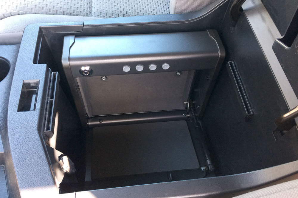

Next I placed the safe inside the console, lined up the mounting holes with the bolts, and secured it in place. For hardware I used flat washers followed by regular hex nuts, followed by nylock nuts. Here’s two images, one with the safe installed and the door open, and one with the door closed.
Finally, one of the questions the video didn’t really answer was whether the original center tray would fit once the safe was installed. As you can see, it actually fits perfectly.
