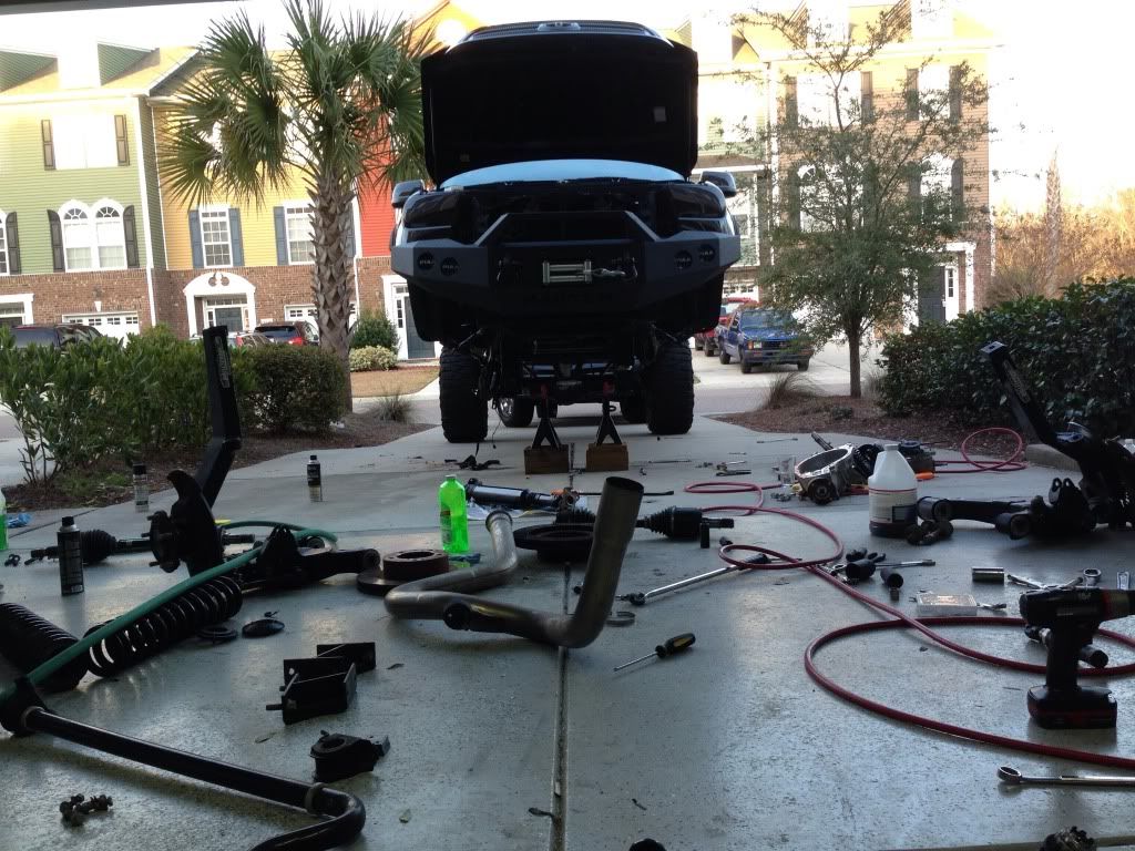

UPDATE 23Feb2014
Well dreading removing the front end and basically waiting to see the carnage I finally did it. I will be re-gearing (ordering parts next week) so figured I should pull apart the clam shell to see how destroyed it is and start searching around for my best options to replace parts if not the entire assembly. Well guess what? No metal chunks in the oil and the inside looks perfect. I don't fukking get it! I did have a shop a while back replace the axle on the left side since I melted part of the cv boot when I was grinding off the bump stops. I pulled the axle apart too. Can't find any evidence of damage. I'm going to a professional take a look at it as well, maybe I'm not seeing something?? I'm going to replace the axles, get it all back together and hope this fixes the issue. I don't know. Anyone have any input?
