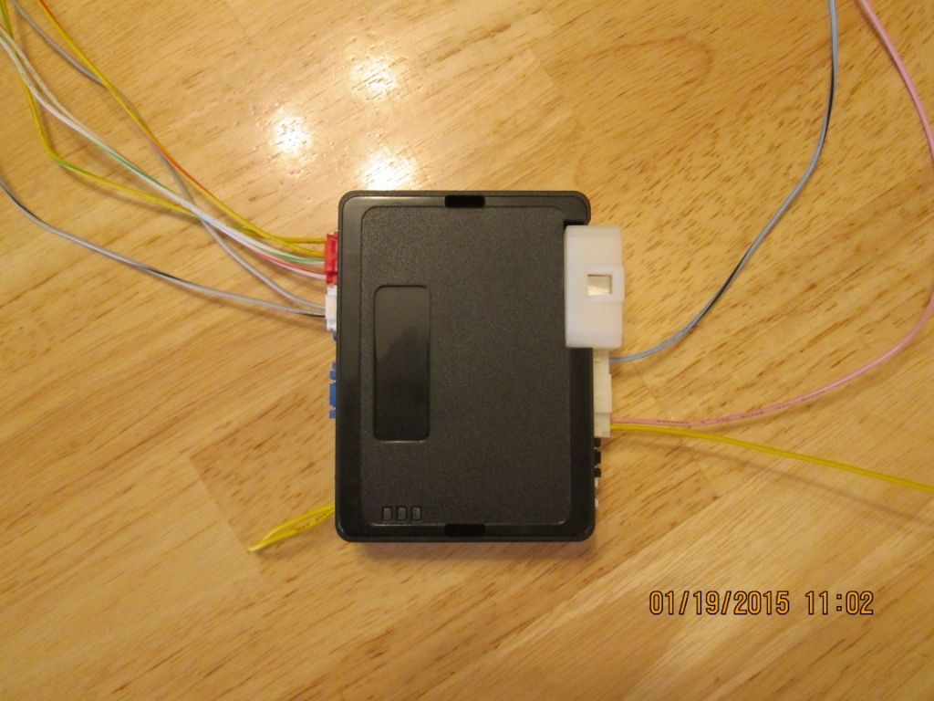

I installed this a little while ago and couldn't be happier. I bought the Evo-One with the Toyota T-Harness from a forum member. If anyone is considering getting a remote start, I highly recommend the Fortin. Stupid simple install.
This is a picture of the wire harnesses that comes with the unit.
Picture of the T-Harness.
Using the T-Harness you eliminate having to cut into your ignition harness. Another huge benefit to this system is you cut down on the number of wires you install. I think you have to tap into 7 wires and cut 2 others. So you go from the harness above to only needing the wires in the following picture.
