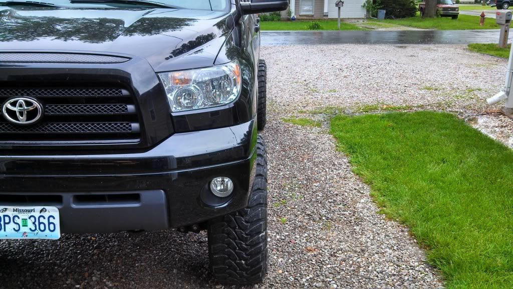

So I have been gathering parts for the last couple months and have come to a fork in the road. I am wanting to go 7" on my tundra and until today thought bds was the way I was going to go. After reading a little it has come to my attention that the zone 5" is the same minus the front spacers and shorter rear blocks. This is where my question comes in. I have already purchased the 7" icons front and rear along with camburg uca's. Would I be better of getting the zone kit and save some money over the bds? My plan is to also buy a rear 4.5" leaf pack. So basically I wouldnt be using much of the bds kit to get to 7". Have I answered my own ? Any thoughts would be appreciated. Thanks
*UPDATE*
ZONE 5" TO 7"
TOYO OC MTS 37X13.50X18
KMC XD ADDICTS 18X9 -12
Almost done. Can't decide if I like the flares or not. I think I am split 60/40 in favor of no flares.
