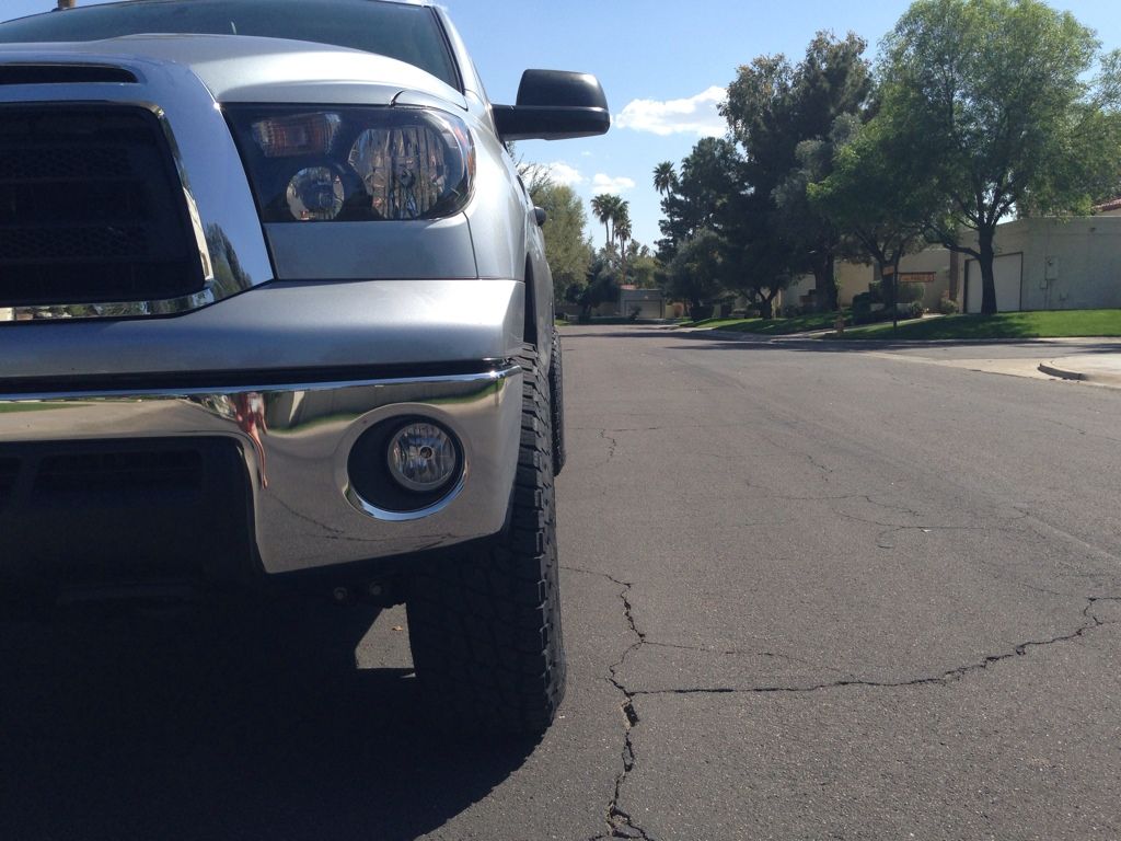

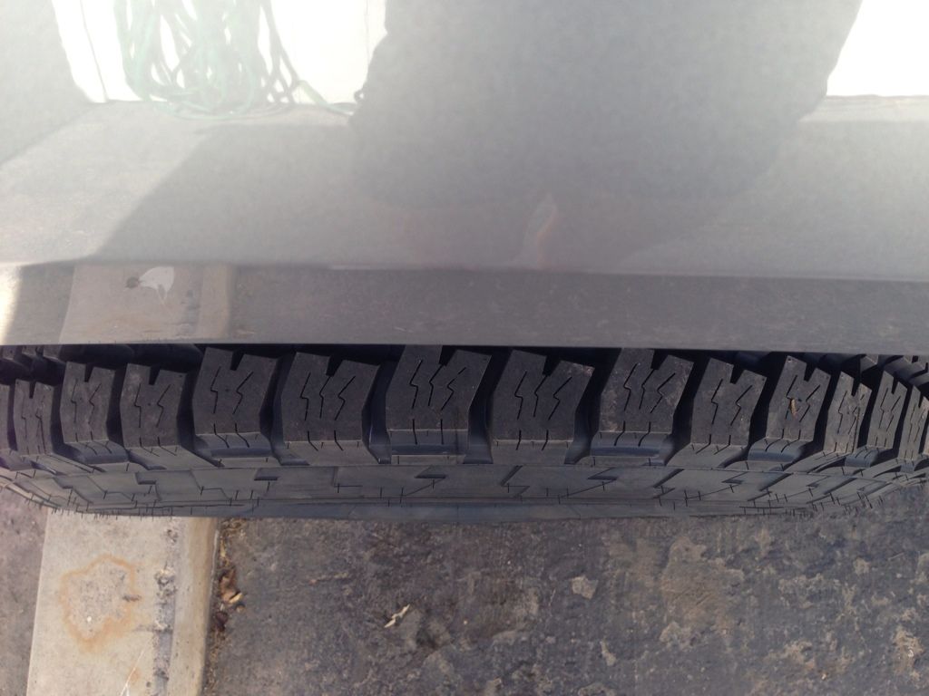

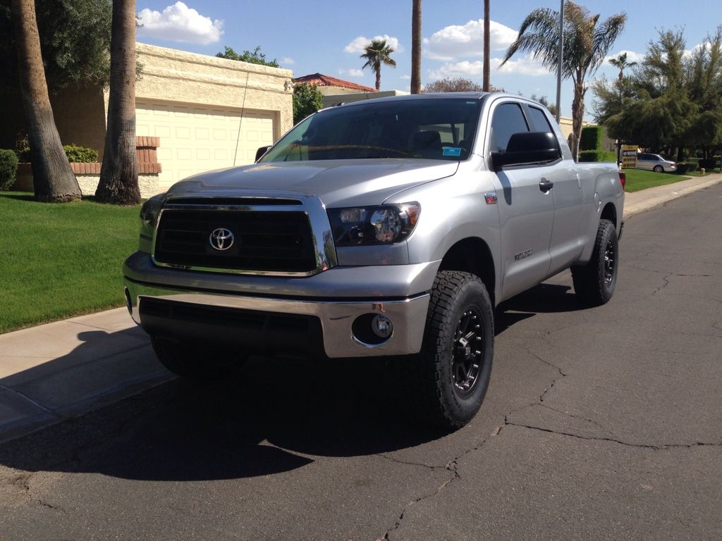

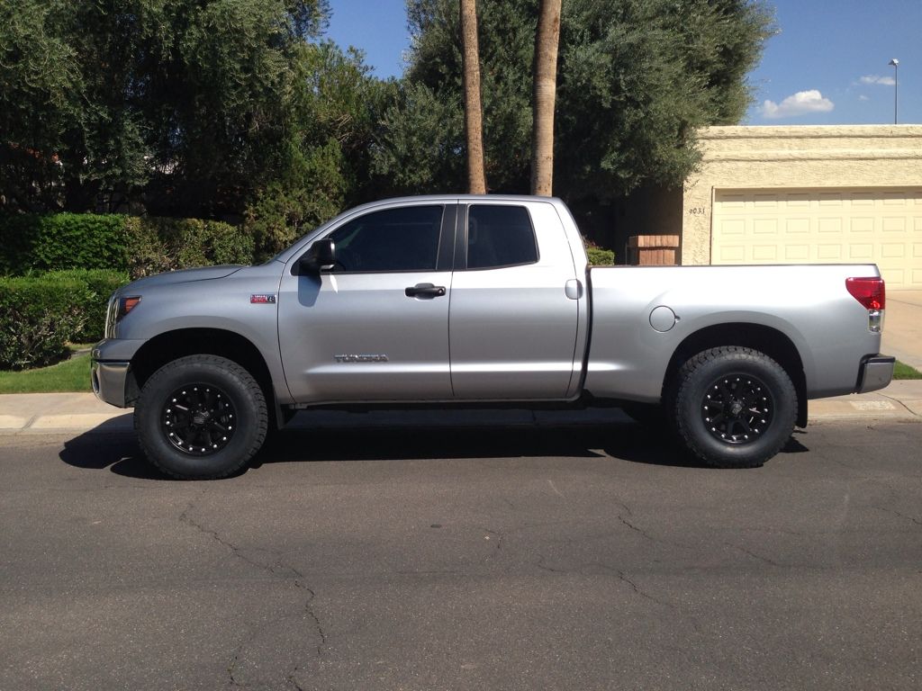

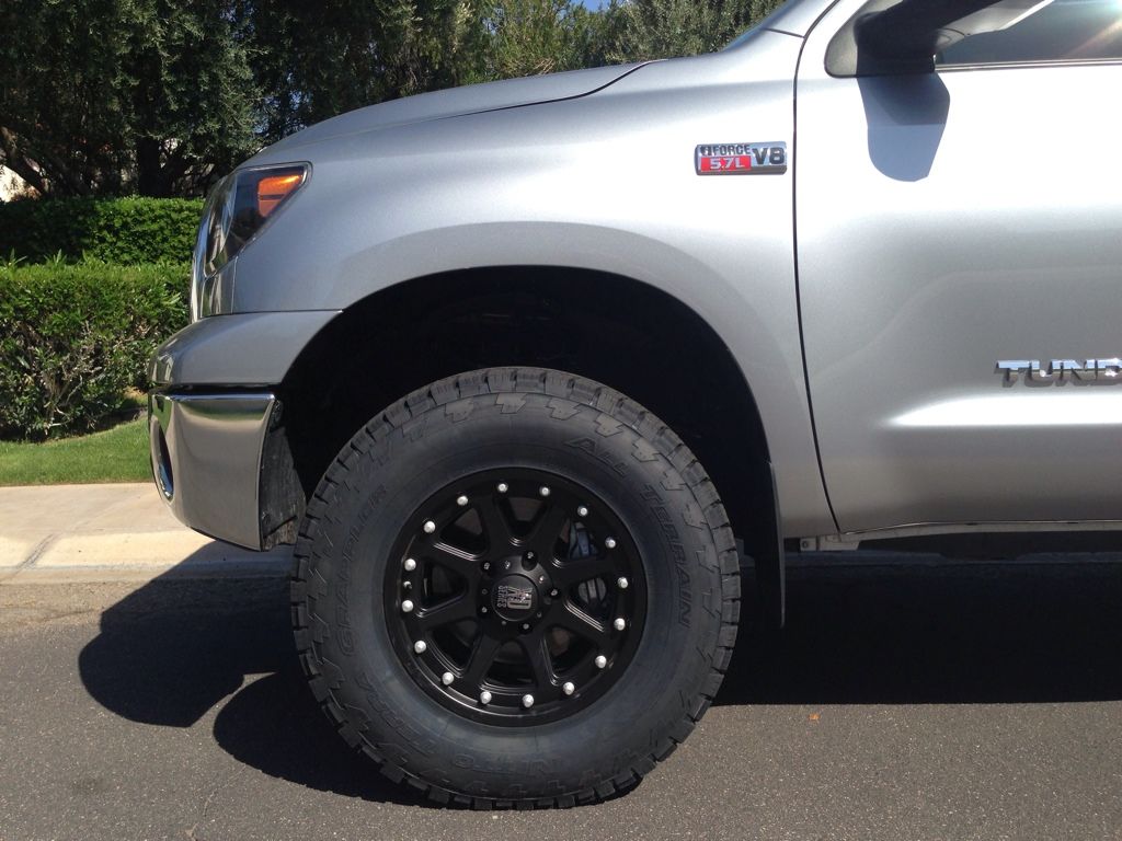

It's like Christmas in March I just got my wheels, tires, and lift on my 2013 DC! Put a 3" rough country spacer up front with 18x9 XD Addicts -18 offset wrapped in 295/70/18 Nittos. Only some slight plastic rub when at turning left so I'm gonna do the wheel clearance mod this weekend. Such a difference in the look and feel of the truck a big thanks to Sierra Expeditions in Mesa for helping with install and discount tire. Couldn't have made a decision without everyone's input on TT as well!
I thought your offset was -18 and was thinking there's no way to avoid hitting the body mount. But you mean +18 mm offset, right?
Looks great.

My bad yes they are +18mm offset thanks for catching that and thank you!
