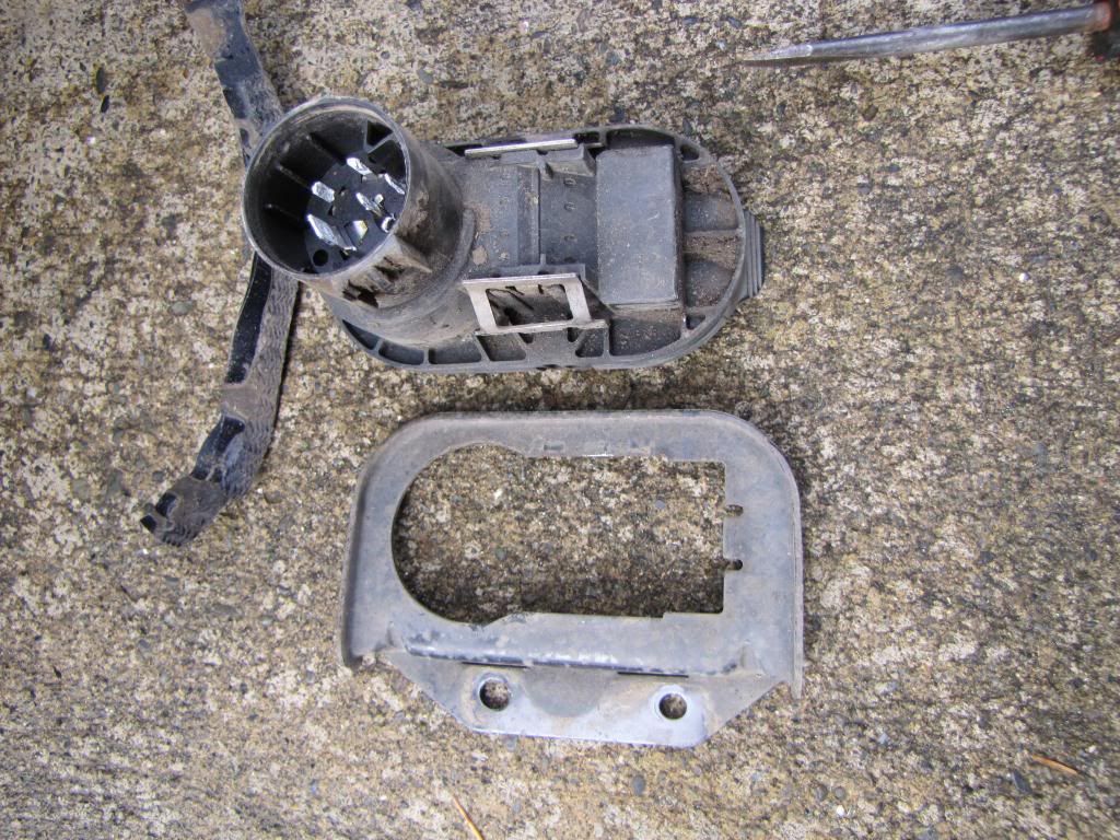

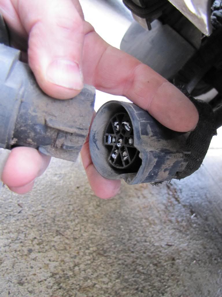

2.) Remove the tape that holds the "mesh" around the plug. Gently bend back the latch and pull hard to separate the plug:

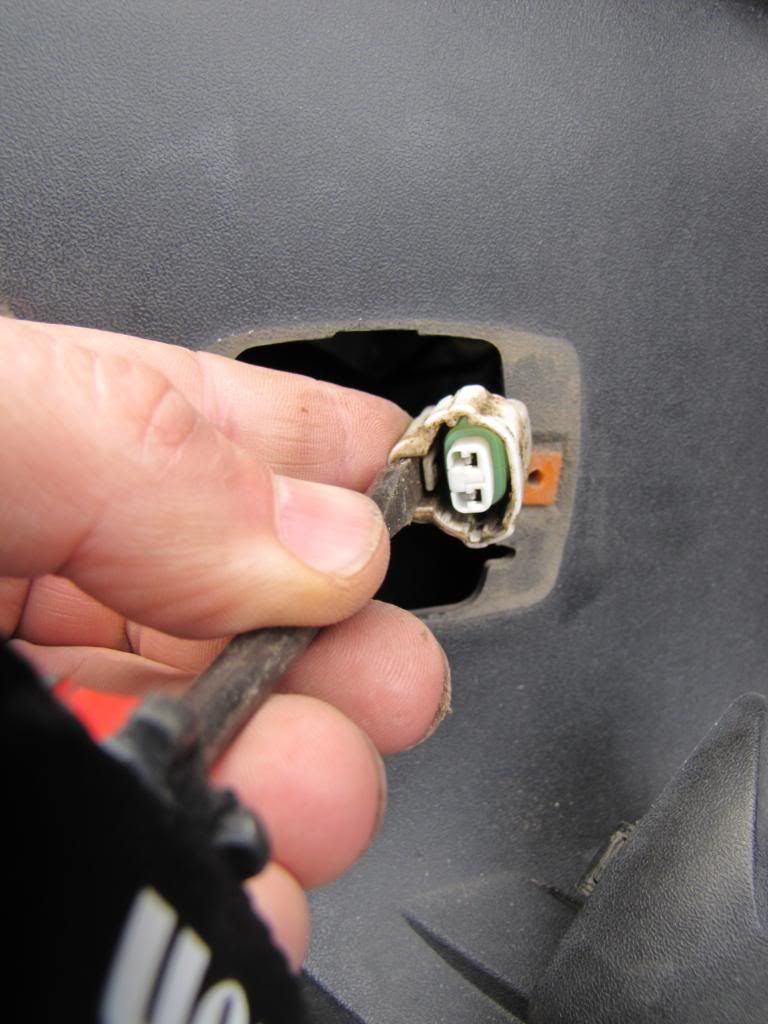

3.) Remove the screws holding the left license plate light. There is a latch that holds the plug in. Insert a flat screw driver to release it. Save it, you've got a spare now!

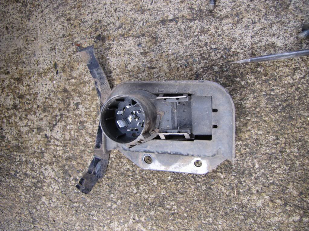

4.) There are 2 metal tabs that hold the plug into the metal bracket. Push them in and work the plug away from the bracket.

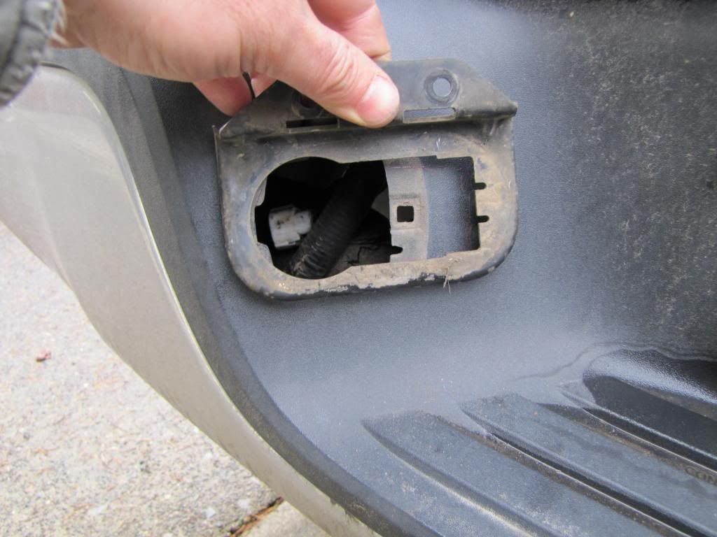

5.) Use the metal bracket as a template and mark:

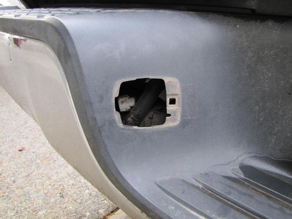

6.) Carefully cut out the plastic. I used a Dremel with cut-off at first but then just used a box knife to trim. It's pretty thin plastic so you could do the whole thing with a box knife. Best to trim a little at a time to get a nice tight fit.

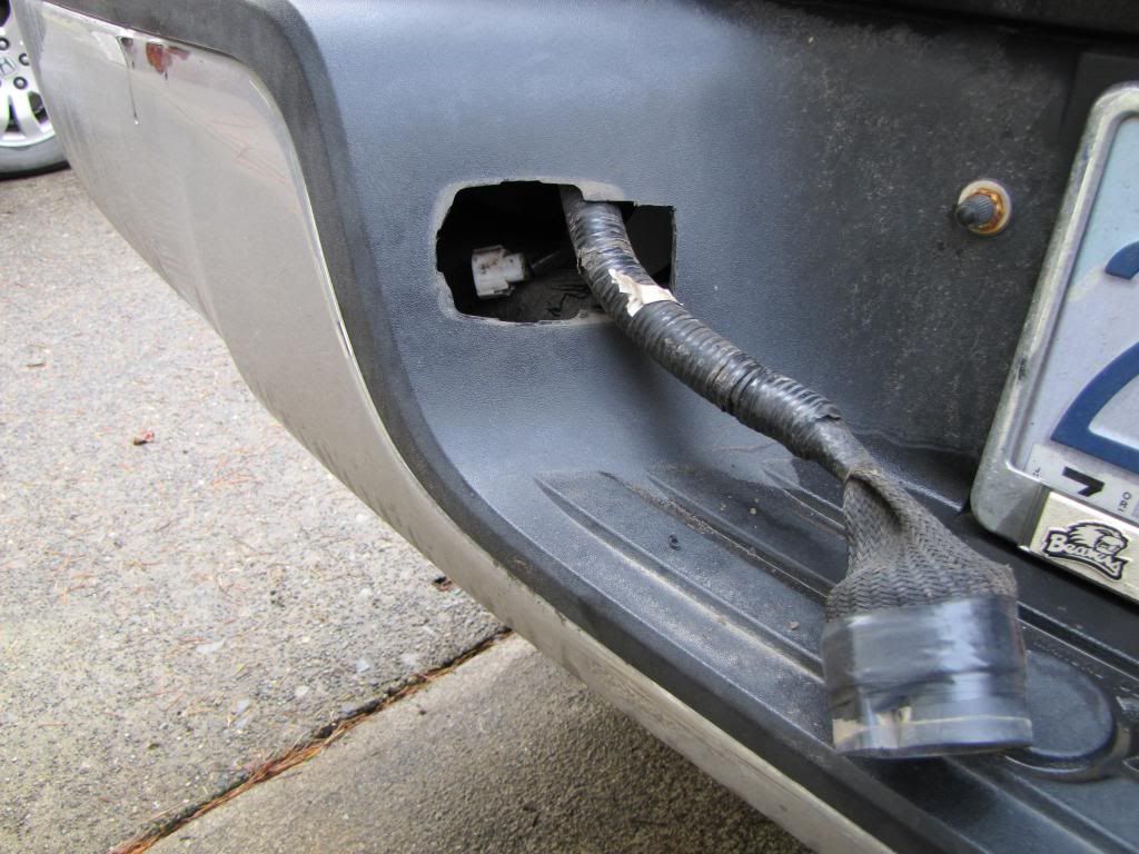

7.) Cut the plastic tie holding the wire bundle to the tow bracket to get enough slack. Pull it through the modified hole. I just used electrical tape to re-attach the mesh to the back of the plug.
8.) Tape up and zip tied the license plate light wire up underneath the bumper. Done
