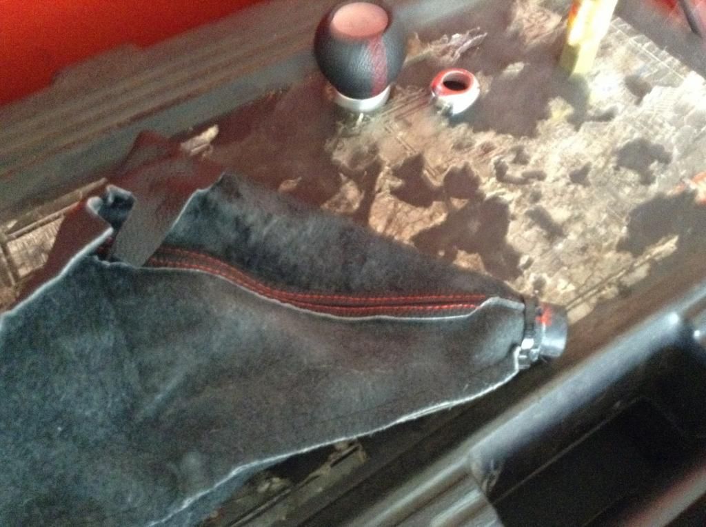

We need to remove the chrome collar, to do this turn the shift boot inside out. Cut the zip tie holding the collar and remove the collar.
Step 2: Preparing shift boot adapter

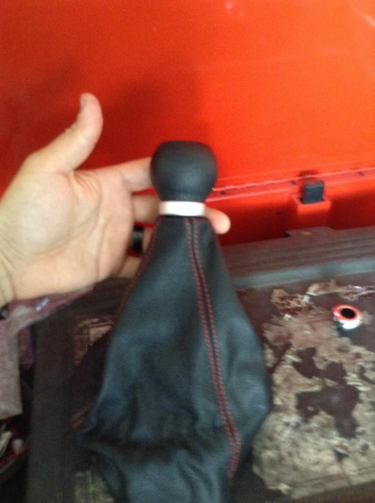

Cut about 2 inches of the heater hose and place it into the inside-out shift boot and zip tie it down. Turn the boot back to normal, about 1/2 of an inch should be exposed out the top of the boot. **You can use some glue if you like to keep the hose from moving down in the boot although I didnt**
Check and make sure the knob shits flush with the boot. If it does not just mess with the heater hose until it does sit flush

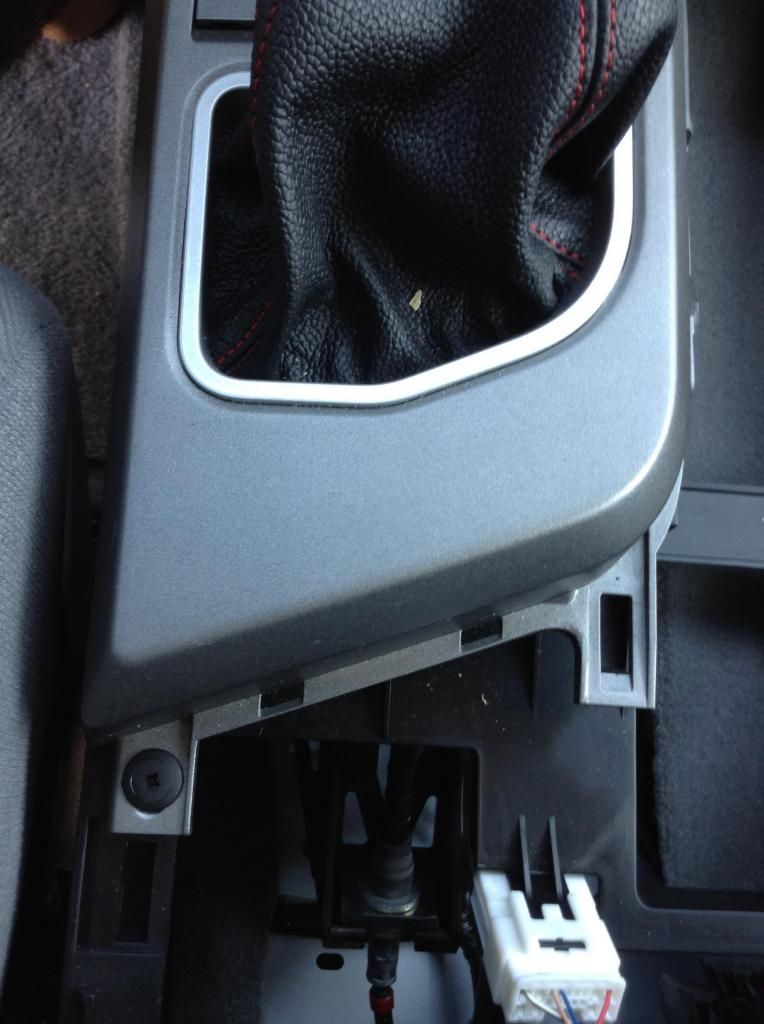

Put the parking brake on and move the shifter to Drive. Remove the cup holders by just pulling up.
Remove hanging file holder in the glove box and Pull the lower console back and out.
Remove the shifter bezel out by removing the plastic clip in the lower left corner and pulling back on the shifter bezel.
Remove the electrical Clip in the back of the Bezel

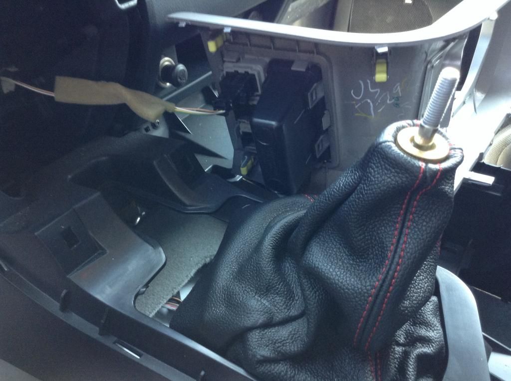

Slide the boot over the shifter and make sure the skirt of the boot is pulled down around the shifter selector ,we will adjust the slack later.
Put the lower console back on along with the cup holders.
Thread on the knob and try to get the shift boot adapter into the bottom of the knob. More than likely you will need to adjust it from here to sit flush.
Now is where you adjust the boot slack. If the boot is too far down and has no slack, it will be very hard to get into and out of park. Too much slack and it will bind when you go into and out of park. Just pull the boot up a little bit at a time, if you pull to much out, remove the lower console again start over.
Once you have the boot set, move the shifter through all the positions and ensure there is no binding. No glue is needed to keep the boot in place, the pressure between the lower console is fine.

First, I think it turned out great. I ordered the parts today to do it myself. I was looking at the 3rd and 4th pictures and was wondering what the gold/copper colored washer is for. I noticed it's not in any of the other pictures. Thanks
Again great job
123 Posts
Discussion Starter #14
That is a female air coupling. That was one of the first things i used as a shift boot adapter. It actually holds to the boot tighter than the rubber hose but the size of the top of the fitting is very inconsistent spec wise.
I went to home depot and only 2 couplings out of the box fit into the shift knob so thats when i thought of using something else.
