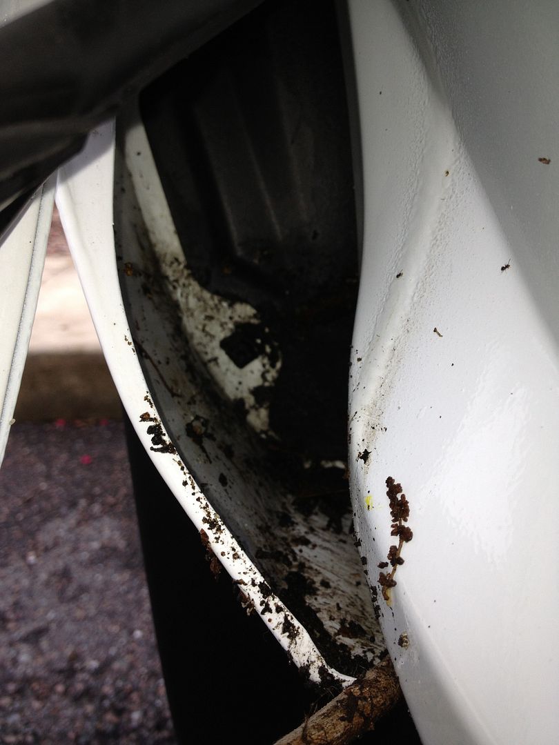

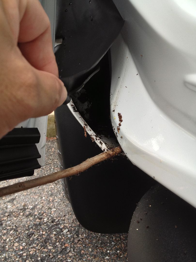

Took a few hours today cleaning the truck up. I was almost done when I started cleaning out the door's. Thats when I saw a small trail of ants relocating to a new spot in the truck.
Thats when I found a huge pile of fall foliage piled up 12" deep in the fender. I have been hearing all kinds of loose chatter for months. All the wind noise is now gone.

Open your drivers side door, then look in the jam. You will see a rubber seal that seals the panel up. Just pull on it at the bottom and out will shoot a birds/rats/squirrel nest.

Mine was the same way when I bought it. One leaf managed to keep about 6" of road dirt stuck in there. Now I check it a couple times a year and so far only find a couple of leaves and no dirt. Funny thing is, it is always on the drivers side. So far I have found nothing at all on the passengers side.
