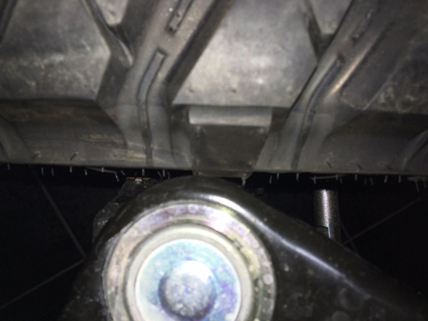

I went in for my 15K mile tire rotation and saw this on the showroom floor.
It is a 16 4X4 SR5 TSS edition CM with a cheap 3/1 leveling kit.
Made a thread on it here;
http://www.tundratalk.net/forums/tu...y-dealership-today-seriously.html#post6830570
Anyway, they have Nitto Grappler M/T 305 55 R20s on it.
I'm considering this tire size when I get new tires after my stock BF KO 285 55 R20s wear out.
I asked about the clearance to the UCA and they said they never had a problem.
I can't even stick my finger in there.
Is this too close?
What say you?

Those 305 55 fill it nicely, but there is what, an 1/8 of an inch clearance..:eek:

I'm here at Toyota of McKinney getting a fuse and I was talking with the parts guy. He said they put 305/55/20 on the TSS wheels all the time. They just do a 3/2 level with them and trim skid plate and inner fender well

Same thing that my dealer said.
My 2WD has no skid plate.
Since lifting my front end, I'm seriously considering a TRD skid plate with the access door for oil changes.
Just not sure if it is worth $400 to me..
