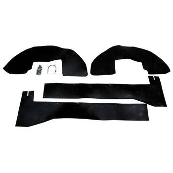

Performance Accessories also manufactures wheel well extensions that we call Gap Guards. These are made from high-quality urethane and are designed for a custom fit on your specific vehicle application.
Performance Accessories Gap Guard kits come complete with instructions and hardware.

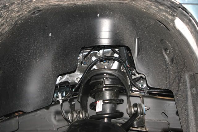

Gap Guards for most Jeep, pickup truck and SUV applications retail under $100 and are easy to install, making them a much-needed and inexpensive addition to any body-lifted vehicle. The first step is to make sure your vehicle’s inner wheel wells are clean and free from caked-on mud. You can hose down dirty wheel wells on your driveway you can see where you’ll mark for drilling several mounting holes.

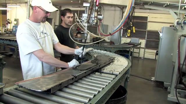

Once the urethane has set, the Gap Guards are removed
from the molds, trimmed and are ready to be packaged.
Each Gap Guard is specifically cut and designed for your application, so the fit is perfectly contoured to your vehicle’s wheel wells. Following the instructions, each Gap Guard is marked to easily identify which location on the vehicle it’s designed to fit.

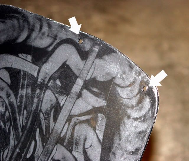

Once you’ve found the right guards for each wheel well, use the Gap Guard as a template and hold it in place inside the wheel well. The Gap Guards have the mounting holes pre-molded into position, making it easy for you to use it as a template to mark around one or two of the holes near the center of the Gap Guard onto the wheel well.

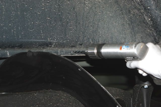

With a ¼-inch drill bit, drill a hole following your marks, into the factory plastic wheel well. Be aware of any hoses or electrical wires behind the wheel well that you can accidentally cut while you are drilling. Insert one of the plastic push clips into the hole and the Gap Guard can now hang in position, allowing you to mark and drill the remaining mounting holes. Once all the holes are drilled and the push clips are in place, you’ve successfully covered the gap in your vehicle’s wheel well.

The mounting holes are pre-molded into the Gap Guards. You
you can use these as a template to mark their positions on
your vehicle's wheel wells for drilling.
Drill and insert the provided push clips to hold the guard
in place. This allows you to dril the rest of the holes using the
guard as a template.
