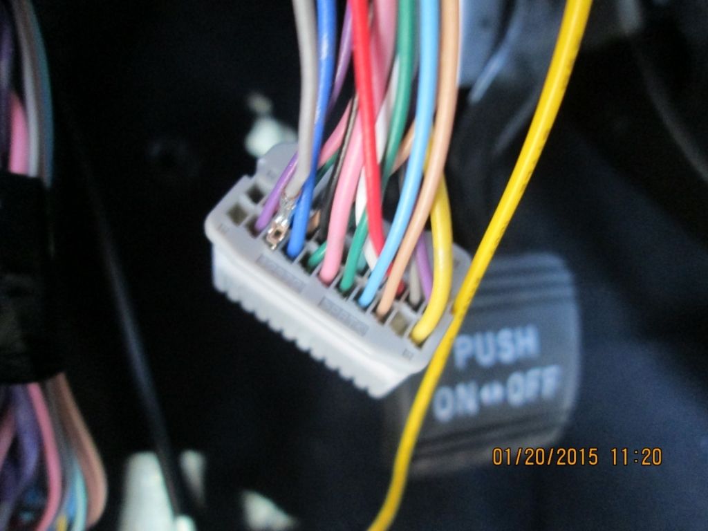

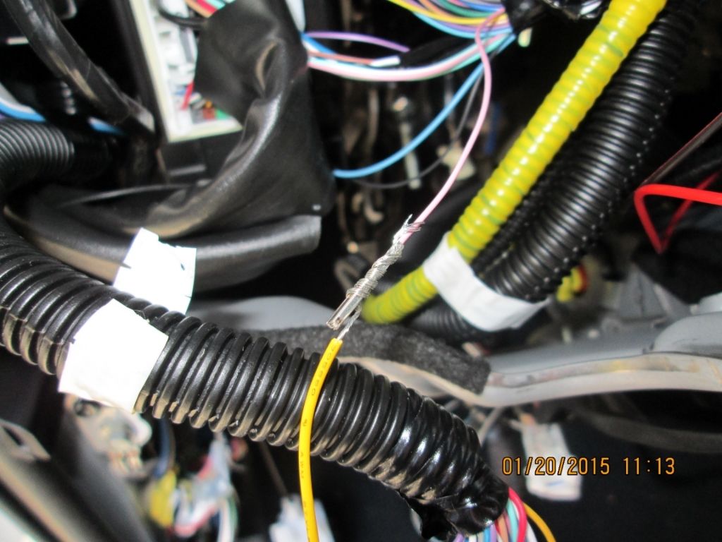

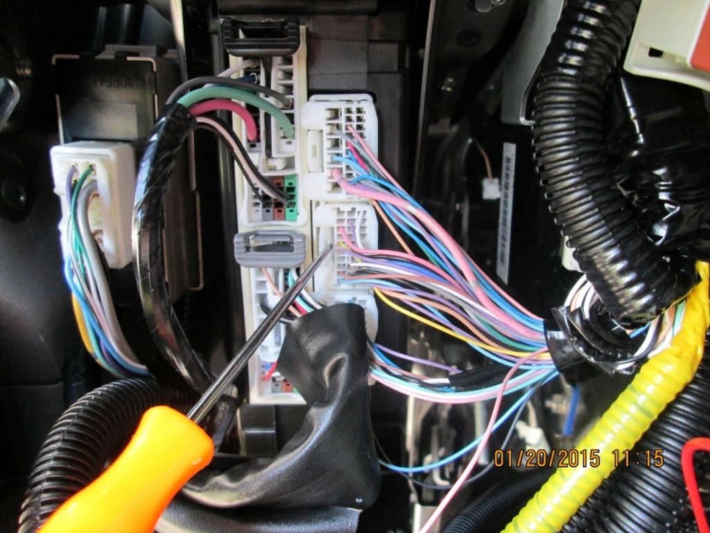

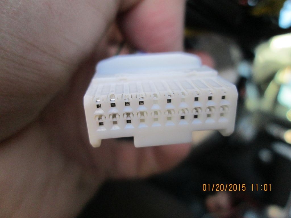

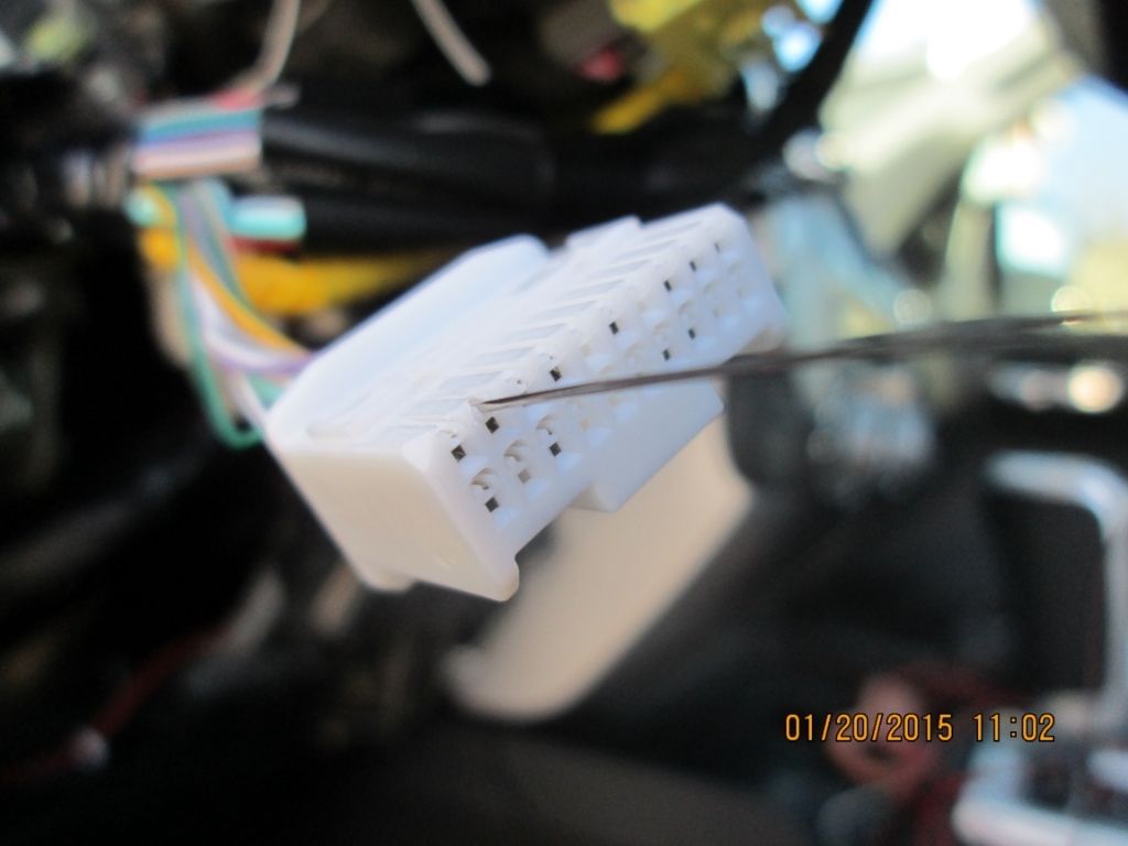

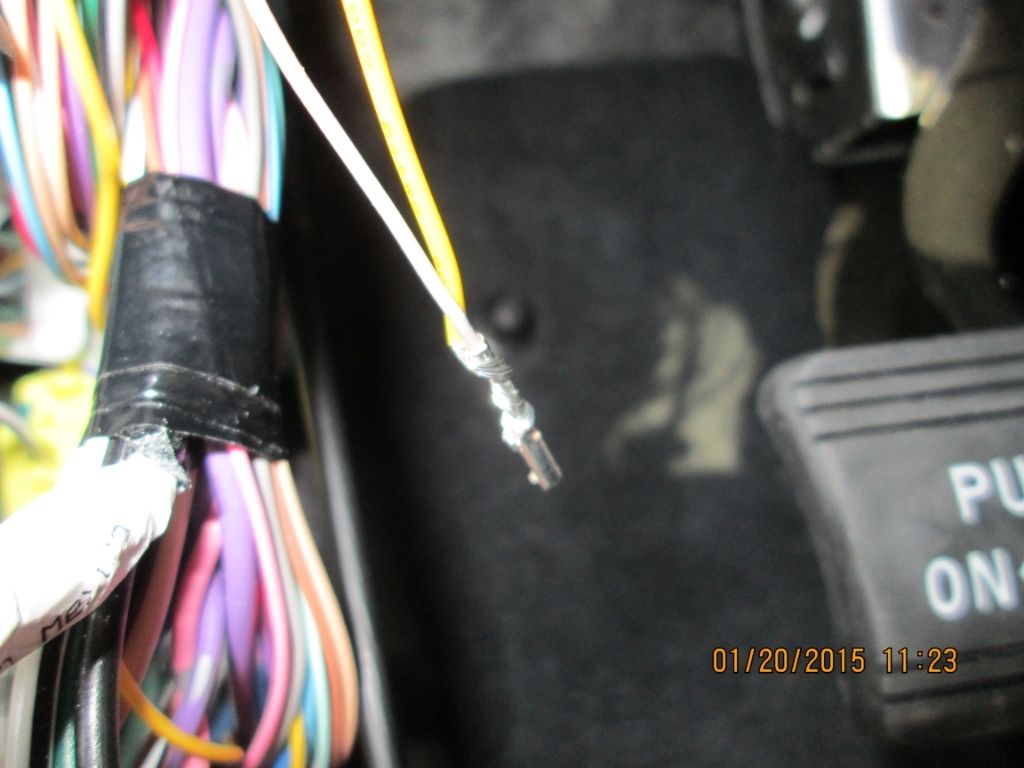

I was just looking through the threads I've subscribed to and had forgotten about this. Very nice and easy. After a couple of checks to make sure I had the correct wires, took all of 10 minutes, including putting the dash and trim back on. :beerchug:
Curious that nobody mentioned that you cannot turn off the fog lights now unless you turn parking lights/headlights off. This makes you unable to run parking lights or headlights with fog lights off......unless I clipped the wrong wire. Everybody else have the same result?
I think you might have got the wrong wire. I double checked mine last night. My fog on/off switch still works fine, regardless if the head lights are on or just on parking lights.
Wonder if the wires are the same for 2018, there have been many changes in the harness introduced in the 2018.
I would love to have a FSM but have not been able to score one
Supposedly Toyota changed the entire electrical system when they added the Safety Sense and new dash for 2018, so it might be different.
