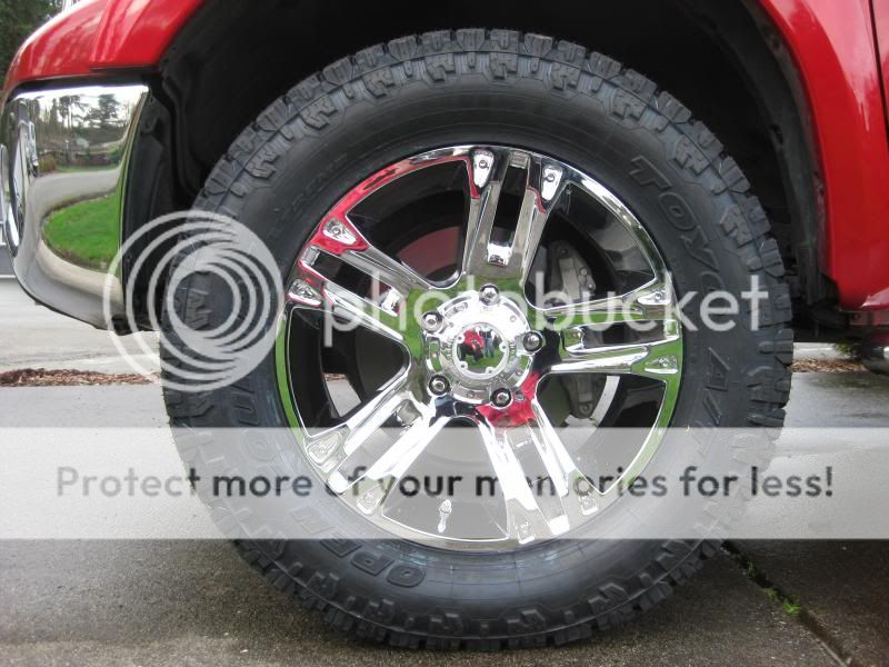

After months of trying to figure out what tires I wanted it came down to 305/55/20 Toyo AT2 or the Cooper AT3. Then I made the mistake of going thru the leveled and 35s thread for the 17th time and just had to join the group. So on went the 35x12.50x20 Toyo Open Country ATII on 20x9 +30 Ultra Mavericks. No rubbing at all after mudflap removal and pushing the front fender liner forward. Lift is Bilstein 5100s at top setting.
