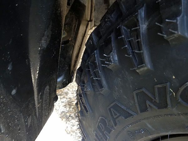

Ok here's a couple better pics as I was just out there looking. So will be subtracting 3" but adding 6" on the lift, so the mount should be sitting around 21.5 through 23 inches I think. If you follow straight up it looks like it would clear, no? I hate the price of tires and the stress buying them brings. :lol:

your offset is killing your clearance, with a +30 you could fit the 35's (34.6").
due to tire dimensions being slightly different you may need to cut back the body mount a touch. Also you may rub on the sway bar but being that it is a round bar and won't do anything so that won't matter (you could remove it like me to handle better off road)
574 Posts
You do not show anything touching but maybe there is more turning left available. It appears you have a 1/4 in. clearance at the closest point. Do they actually touch or are you afraid of only 1/4 in. clearance? I only have 1/4 in. clearances at the back and to the spring tower. I was able to get about 3/4 in. in the front. Mine do not rub but mine are not 12.5 wide either. I think mine are 11.2 total width.
