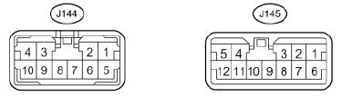

Now for the factory amp wiring diagram. The factory pinout diagram is a little confusing, so here is my explanation:
In order to follow this diagram, hold the wiring harness you bought so the tab is on top and you are looking at the pins (looking "into" the harness).
If you look at the Toyota Wiring Diagram, you will see color code abbreviations. Here is the translation:
B = Black
W = White
BR = Brown
BE = Beige
L = Blue
V = Violet
SB = Sky Blue
R = Red
G = Green
LG = Light Green
P = Pink
Y = Yellow
GR = Gray
O = Orange
Note: I have included the colors as listed in the diagram. I did not confirm the colors, they are just included for convenience. Also note there are two white wires on the 145 harness.
The smaller harness, J144, has the power wire, accessory switched wire, ground wire, and the outputs to the front door speakers.
J144 (Smaller factory amp harness)
Pin 1 - Front Right Output to Speaker (+) - Light Green
Pin 2 - Front Left Output to Speaker (+) - Violet
Pin 3 - Accessory/Switched 12v [Remote In] - Sky Blue
Pin 4 - 12v Constant [Power] - Red
Pin 5 - Front Right Output to Speaker (-) - Blue
Pin 6 - Front Left Output to Speaker (-) - Pink
Pin 7 - Ground - White and Black (NOTE: The factory wiring diagram says that ground is Pin 9, but I confirmed that Pin 7 is actually the ground. It is a white and black wire. )
J145
Pin 1 - Front Left Signal (+) - Brown
Pin 2 - Front Right Signal (+) - Pink
Pin 3 - Rear Left Signal (+) - Light Green
Pin 4 - Rear Right Output to Speaker (+) - Red
Pin 5 - Rear Left Output to Speaker (+) - White
Pin 6 - Front Left Signal (-) - Beige
Pin 7 - Front Right Signal (-) - Gray
Pin 8 - Rear Left Signal (-) - Black
Pin 9 - Rear Right Signal (+) - Blue
Pin 10 - Rear Right Signal (-) - White
Pin 11 - Rear Right Output to Speaker (-) - Violet
Pin 12 - Rear Left Output to Speaker (-) - Green
If you want to power the factory speakers with your new amp or if you want to use factory wiring, you can run speaker wire to the output pins above from your amp. I tried both ways and ended up running new speaker wire only because I am picky. The factory wiring sounded good. The factory speakers also sounded surprisingly good when pushed with more power from my amp. I ended up running new wire because I put in component speakers in the front doors and wanted to keep the crossovers in the cab for easy access to the tweeter attenuation switch.
Because the J145 harness has two extra pins, you will have to manually plug in 2 pins into the factory amp harness. You can see what I mean in the following picture. Its a crappy picture of it all wired up before wrapping everything up and tucking it away:
The speakers in the dash still play, and actually add some nice fill. They are overpowered enough by my front speakers so they aren't an issue.
You could alternatively tap into the wires after the amp, but I was unsure how the amp processed the sound signal. If anyone else tapped into the signal after the amplifier, please post your results.
I installed an LC6I at the factory amp location. I did not remove the factory amp, as I wanted to keep everything as stock as possible, but it is obviously not plugged in. I am running a Kicker ZX700.5 amplifier which powers Infinity Kappa 60.9cs 6.5" component speakers in the front doors, with the tweeters installed in Platinum edition sail panels. My rear speakers are still factory, and they take the extra power from the Kicker amp surprisingly well. I built a custom box that fits under the rear seat and have a single 10" MB Quart shallow Mount RLP254 subwoofer installed. On retrospect, I should have built a dual enclosure and ran two of the subs. The one sound good, but I have to add some bass boost for it to be as loud as I like. I do enjoy the extra floor space for storage though.
Hope this all helps someone out there.

just unplug factory amp. period. the plugs in that amp have everything you need for the lc7i. the inputs go to the lc7i then the speaker side, outputs of the factory amp go to the aftermarket amp speaker out. take factory amp out, i can't believe this shop is making this that difficult. this should of been fix in ten min.
3
Wanted to give you guys an idea of what im looking at.
if the install was done correctly, you can simply unplug the white plugs on the right in the first pic and everything should work the same. Theres no reason to keep the amp when you added an amp to replace that stock one.
If i unplug the larger J145 connector on the right of the first pic the LC7i turns off. I have not unplugged the other connector i will try that for shits and giggs
so its not installed right. go to the shop, have them unplug the stock amp, and ask them to make it work without the stock amp. they should know how this works. the signal coming off the head unit is plenty good to run the lc7i.... lots of us have done it.
10-4. I appreciate your patience.
