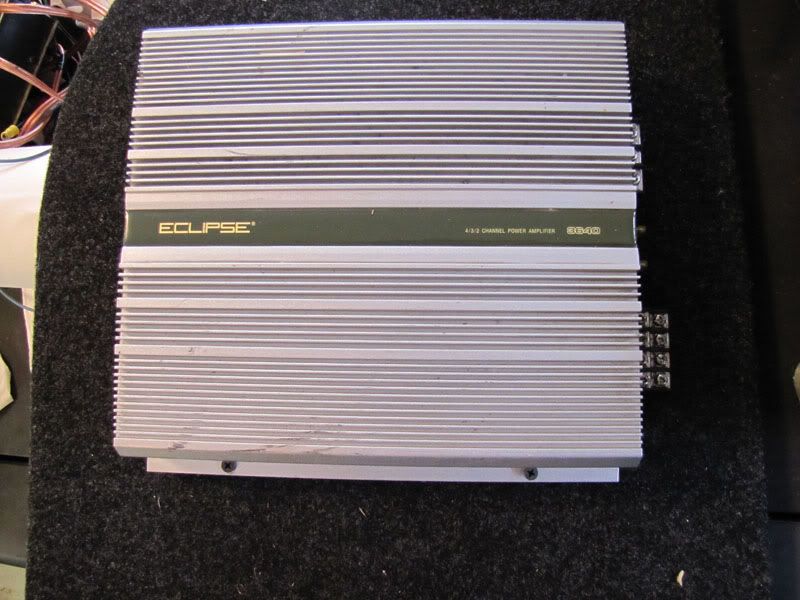

Eclipse 3640 for 6x9's and 6 1/2's

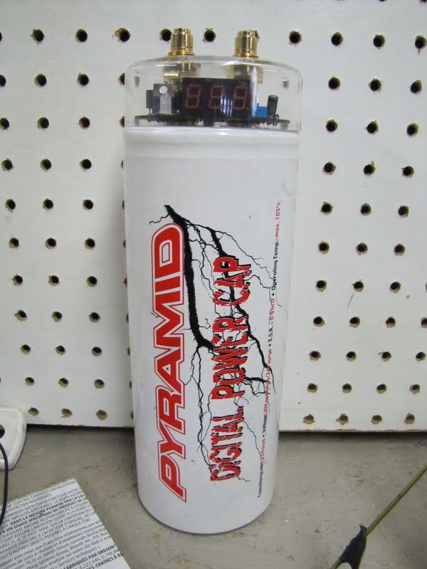

Power Cap by Pyramid
Somewhere in my dad's garage I might find two Eclipse 3 1/4s for the dash still attached to some old kick panels from my Cuda in high school.

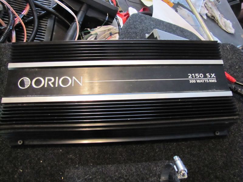

Did some more wire clean ups. I got the Orion amp from a police auction in 1997. The main power, remote power, ground, and speaker outs all were cut very short (<2") by the person who last "had" the amp before the police got it. I am waiting for some 8ga wire to arrive to finish the Orion, but I cut out the 90's era crimp connections on the leads and replaced them with solid solder butt connectors and heat shrink tubing and added female connectors tothe ends to ease any future movement. The Orion has a pin style connector and whos knows if I could ever find another if the wires were to keep getting shorter on every install. I think this amp was new in 1992.

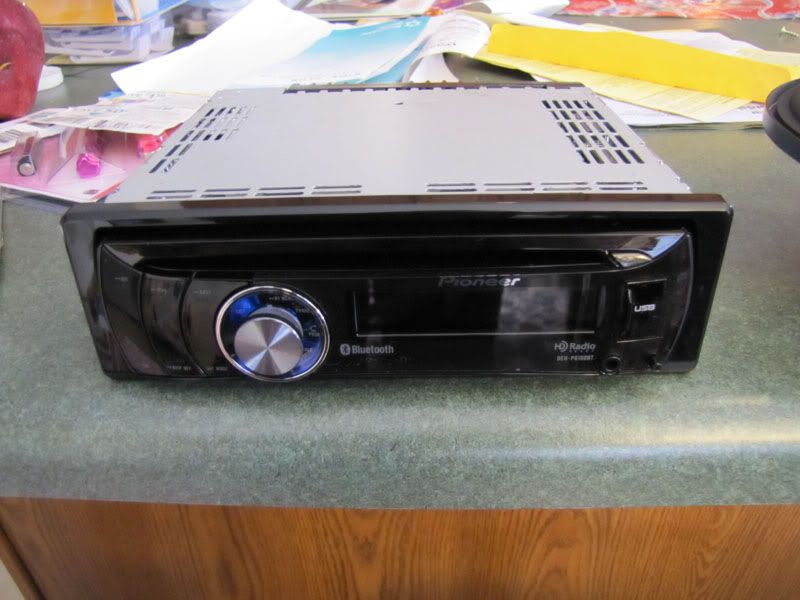

I also put some male connectors on the back of the Pioneer:

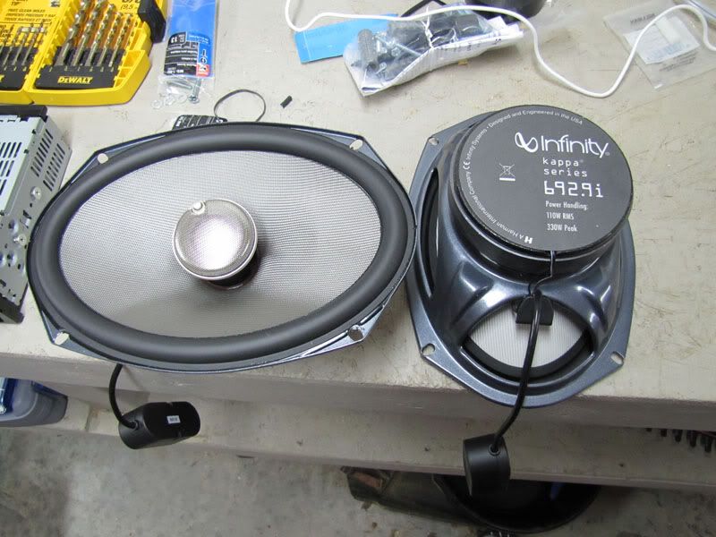

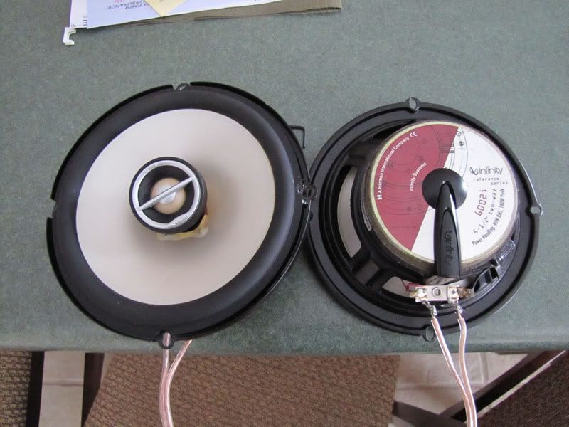

Next change to the Tundra equipment line up. Infinity Kappa 6x9 and Infinity Reference 6.5 out and new 3 ways in:
HSK 163's. Since the front doors from the factory were 6x9's, I am considering mounting the 6.5's and 3's in the space of the 6x9's with some custom baffles and the tweets at the top of the door panel. The dash has speaker mounts on the top corners. The 3's or tweets would fit there but they are aimed right at the windshield.
