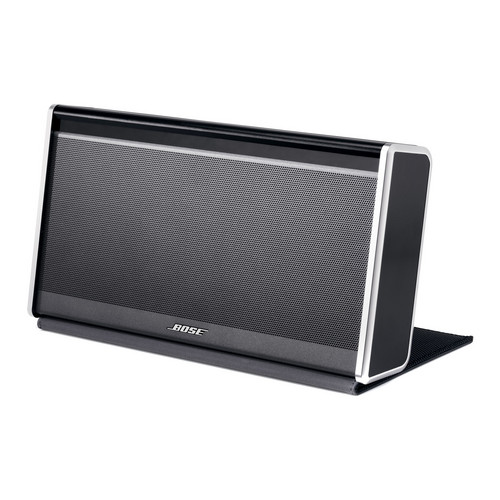

Post your latest purchase - Page 87 - TundraTalk.net - Toyota Tundra Discussion Forum
Go Back   TundraTalk.net - Toyota Tundra Discussion Forum > Member Area > Off-Topic Discussion
Closed Thread
Old 12-08-2012, 08:10 PM   #1291 (permalink)
AMARTIN's Avatar
Join Date: Oct 2012
Location: Virginia
Posts: 126
Thanks: 62
Thanked 181 Times in 82 Posts
AMARTIN is offline
The Following 7 Users Say Thank You to AMARTIN For This Useful Post:
06dblecab (12-10-2012), AnywhereInTX (12-09-2012), BigBlueAZ (12-09-2012), dikkie (12-09-2012), Mr. Creosote (12-08-2012), Ogtoyfan (12-13-2012), oyibo46 (12-09-2012)
Old 12-08-2012, 10:01 PM   #1292 (permalink)
"Thread killer"
Dragos28's Avatar
Join Date: Oct 2012
Location: bakersfield ca
Posts: 2,112
Thanks: 1,823
Thanked 4,128 Times in 1,603 Posts
ImageUploadedByAG Free1355022061.141971.jpgImageUploadedByAG Free1355022073.683962.jpg
Under seat storage!
Sent from my iPhone using AutoGuide.com Free App
Silver Sky №28
Dragos28 is offline
The Following 5 Users Say Thank You to Dragos28 For This Useful Post:
06dblecab (12-10-2012), BigBlueAZ (12-09-2012), dikkie (12-09-2012), Mr. Creosote (12-08-2012), Ogtoyfan (12-13-2012)
Old 12-09-2012, 11:36 AM   #1293 (permalink)
Sleepin's Avatar
Join Date: Mar 2012
Location: Western, CO.
Posts: 852
Thanks: 578
Thanked 1,920 Times in 733 Posts
Sent from my iPhone using AutoGuide.com App
Eric
2010 Silver Sky CrewMax Redrock Platinum
Corsa Exhaust
LED DRLs and Interior
Genuine Toyota bumpers, lift, wheels, steps, radio, windshield etc.
Sleepin is offline
The Following 10 Users Say Thank You to Sleepin For This Useful Post:
06dblecab (12-10-2012), BigBlueAZ (12-09-2012), dikkie (12-09-2012), jeffhrb8 (01-16-2013), kstateskier (12-10-2012), Mr. Creosote (12-09-2012), nobonesBP (12-11-2012), Ogtoyfan (12-13-2012), Tuurtje (12-09-2012), Vettelover84 (12-09-2012)
Old 12-09-2012, 12:57 PM   #1294 (permalink)
planomateo's Avatar
Join Date: Jul 2010
Location: North Dallas
Posts: 595
Thanks: 49
Thanked 785 Times in 394 Posts
Originally Posted by whitemeat640 View Post
I've got a merkur and love it. He could also check a local antique store, I've picked a few from them for $5. Most need a cleaning with some simple green and a toothbrush. And to start off I would not get feathers, get a sample pack from westcoastshaving.com for a few dollars and see what works for you.
But then another strange phenomenon occurs and you want to try soaps and different creams, then the aftershaves, then the razors and brushes. Then you'll get ballsy and try a straightedge. It's a never ending cycle. I had to promise my wife and myself not to buy anything else until I work my way trough the surplus of creams and aftershaves I have now.
Ha, I have no interesting in trying a straightedge. I have tried a few different blades and like the feathers the best. Was just using that as an example of what you could buy, you could get cheaper and save more money if that is your thing.
2010 CrewMax SR5 Slate Metallic 5.7L TRD
Mods: TRD Supercharged, TRD Sway Bar, N-Fab 4 step, Window Tint, Door Sill Protectors, debadged, WeatherTech Digital mats, V-Led Interior Lights - 4 LED High Power 6K, Bilstein 5100's in the rear
planomateo is online now
The Following 5 Users Say Thank You to planomateo For This Useful Post:
06dblecab (12-10-2012), BigBlueAZ (12-09-2012), dikkie (12-10-2012), Mr. Creosote (12-09-2012), Ogtoyfan (12-13-2012)
Old 12-09-2012, 04:28 PM   #1295 (permalink)
Join Date: Nov 2010
Location: Statesboro. GA
Posts: 46
Thanks: 13
Thanked 39 Times in 21 Posts
Originally Posted by planomateo View Post
Ha, I have no interesting in trying a straightedge. I have tried a few different blades and like the feathers the best. Was just using that as an example of what you could buy, you could get cheaper and save more money if that is your thing.
I've got a straightedge and rarely use it. I just do not get a good shave with it, it pulls more than cuts. I may need to go get it honed again. I also love the feathers; super sharp but expensive. Sorry guys back on track, no pictures but I just got an ice cold Coke zero. Delicious
Stock for now...
whitemeat640 is offline
The Following 5 Users Say Thank You to whitemeat640 For This Useful Post:
06dblecab (12-10-2012), BigBlueAZ (12-09-2012), dikkie (12-10-2012), Mr. Creosote (12-09-2012), Ogtoyfan (12-13-2012)
Old 12-09-2012, 06:48 PM   #1296 (permalink)
Cereal Killer
Mr. Creosote's Avatar
Join Date: Nov 2009
Location: Canada
Posts: 16,654
Thanks: 158,540
Thanked 51,294 Times in 16,027 Posts
Normal diet pops have their taste overwhelmed by partame but somehow Coke Zero manages to do better. Must be the ginger.
Attention environmentalists, reduce emissions from this:
Mr. Creosote is offline
The Following 4 Users Say Thank You to Mr. Creosote For This Useful Post:
06dblecab (12-10-2012), dikkie (12-10-2012), nobonesBP (12-11-2012), Ogtoyfan (12-13-2012)
Old 12-10-2012, 02:25 AM   #1297 (permalink)
F.B.I.
pdizzle's Avatar
Join Date: Aug 2011
Location: Hawaii
Posts: 1,800
Thanks: 1,008
Thanked 2,691 Times in 1,193 Posts
Those drinks make you hungrier. Zero Sum game.
'11 Platinum CM - 30% tint Fronts & 5% backs / Recon 3rd brake & tails / Amp Power Steps / LRO 3/1 / Digi-fit mats / Volant CAI / 20" Cranks +0 / 33x12.5 Toyo M/Ts / Corsa Sport / Sound upgrades / Sparks LED DRLs / RIjon Emblem / RIjon MS-8 Screen / Craven Stubby / VSC Bypass Mod / Debadged / Interior LEDs / BHLM / Oracle Halos & DRL
Team ZeR0
pdizzle is offline
The Following 4 Users Say Thank You to pdizzle For This Useful Post:
06dblecab (12-10-2012), dikkie (12-10-2012), Mr. Creosote (12-10-2012), Ogtoyfan (12-13-2012)
Old 12-10-2012, 02:40 AM   #1298 (permalink)
Johnny 5's Avatar
Join Date: Aug 2009
Location: MT
Posts: 3,039
Thanks: 9,962
Thanked 12,008 Times in 3,128 Posts
Originally Posted by Mr. Creosote View Post
Normal diet pops have their taste overwhelmed by partame but somehow Coke Zero manages to do better. Must be the ginger.
Coke Zero is made with Gingers???
Johnny 5 is offline
The Following 6 Users Say Thank You to Johnny 5 For This Useful Post:
06dblecab (12-10-2012), Casper 07 (12-11-2012), dikkie (12-10-2012), Mr. Creosote (12-10-2012), nobonesBP (12-11-2012), Ogtoyfan (12-13-2012)
Old 12-10-2012, 08:32 AM   #1299 (permalink)
Super Moderator
UnCivilEng's Avatar
Join Date: Oct 2011
Posts: 11,519
Thanks: 9,012
Thanked 25,576 Times in 7,134 Posts
Originally Posted by Johnny 5 View Post
Coke Zero is made with Gingers???
wow
UnCivilEng is offline
The Following 4 Users Say Thank You to UnCivilEng For This Useful Post:
06dblecab (12-10-2012), dikkie (12-10-2012), Mr. Creosote (12-10-2012), Ogtoyfan (12-13-2012)
Old 12-10-2012, 08:48 AM   #1300 (permalink)
Polak's Avatar
Join Date: Dec 2010
Location: KIND
Posts: 421
Thanks: 104
Thanked 1,390 Times in 334 Posts
Maxpedition Falcon II
I needed a new work backpack and they had BOGO on cyber monday for all their digi camo bags. Didn't want digi camo, but couldn't pass up the deal.
Haven't decided if I want to sell the 2nd one or keep it for my new bug out bag.
Attached Images
File Type: jpg Max.jpg (199.2 KB, 205 views)
'12 CM TRD, Pyrite Mica
Polak is online now
The Following 5 Users Say Thank You to Polak For This Useful Post:
06dblecab (12-10-2012), dikkie (12-10-2012), Mr. Creosote (12-10-2012), Ogtoyfan (12-13-2012), UnCivilEng (12-10-2012)
Old 12-10-2012, 08:49 AM   #1301 (permalink)
Polak's Avatar
Join Date: Dec 2010
Location: KIND
Posts: 421
Thanks: 104
Thanked 1,390 Times in 334 Posts
Originally Posted by Johnny 5 View Post
Coke Zero is made with Gingers???
That's a lot of crazy in one location.
'12 CM TRD, Pyrite Mica
Polak is online now
The Following 5 Users Say Thank You to Polak For This Useful Post:
06dblecab (12-10-2012), dikkie (12-10-2012), Mr. Creosote (12-10-2012), Ogtoyfan (12-13-2012), UnCivilEng (12-10-2012)
Old 12-10-2012, 09:13 AM   #1302 (permalink)
JCv2.0's Avatar
Join Date: May 2008
Location: The Gunshine State
Posts: 37,701
Gameroom cash: $2213353
Thanks: 4,543
Thanked 26,518 Times in 10,948 Posts
iTrader: (8)
Originally Posted by Polak View Post
Maxpedition Falcon II
I needed a new work backpack and they had BOGO on cyber monday for all their digi camo bags. Didn't want digi camo, but couldn't pass up the deal.
Haven't decided if I want to sell the 2nd one or keep it for my new bug out bag.
I'll take it
JCv2.0 is offline
The Following 4 Users Say Thank You to JCv2.0 For This Useful Post:
06dblecab (12-10-2012), dikkie (12-10-2012), Mr. Creosote (12-10-2012), Ogtoyfan (12-13-2012)
Old 12-10-2012, 11:47 AM   #1303 (permalink)
Sleepin's Avatar
Join Date: Mar 2012
Location: Western, CO.
Posts: 852
Thanks: 578
Thanked 1,920 Times in 733 Posts
Originally Posted by Polak View Post
That's a lot of crazy in one location.
...and not one soul to be found...
Eric
2010 Silver Sky CrewMax Redrock Platinum
Corsa Exhaust
LED DRLs and Interior
Genuine Toyota bumpers, lift, wheels, steps, radio, windshield etc.
Sleepin is offline
The Following 3 Users Say Thank You to Sleepin For This Useful Post:
dikkie (12-10-2012), Mr. Creosote (12-10-2012), Ogtoyfan (12-13-2012)
Old 12-10-2012, 11:51 AM   #1304 (permalink)
Join Date: Apr 2009
Posts: 2,441
Thanks: 402
Thanked 2,151 Times in 974 Posts
iTrader: (5)
Originally Posted by JCv2.0 View Post
I'll take it
I'm second in line!!!!!
30PlusRetlaw is offline
The Following 3 Users Say Thank You to 30PlusRetlaw For This Useful Post:
dikkie (12-10-2012), Mr. Creosote (12-10-2012), Ogtoyfan (12-13-2012)
Old 12-10-2012, 04:15 PM   #1305 (permalink)
SalsaRedPearl's Avatar
Join Date: Jul 2009
Location: PA
Posts: 835
Thanks: 186
Thanked 344 Times in 176 Posts
Originally Posted by Sleepin View Post
Cute!
2009 Crewmax Limited 4x4- 5.7
Volant CAI / Stebel Big Daddy Horns / Line-X Bed Liner / Extang Trifecta Tonneau / TRD T-Handle Shifter / Tinted Front Windows / Toyota 20" Carved Alloys / Cooper Zeon LTZs / iPod Interface Cable / Fog Light Mod / Interior LEDs
SalsaRedPearl is offline
The Following 4 Users Say Thank You to SalsaRedPearl For This Useful Post:
dikkie (12-11-2012), Mr. Creosote (12-10-2012), Ogtoyfan (12-13-2012), Sleepin (12-10-2012)
Closed Thread
  TundraTalk.net - Toyota Tundra Discussion Forum > Member Area > Off-Topic Discussion
HTML code is On
All times are GMT -4. The time now is 07:59 AM.
